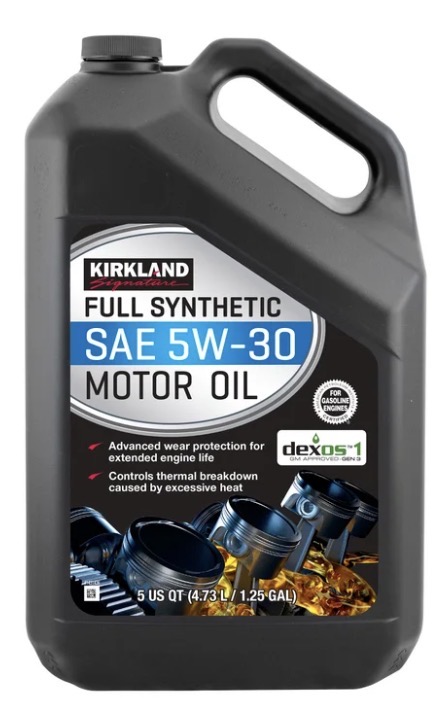

    Tried googling:
    ambient temp range 5w20 versus 5w30
    Considering your summer temps, maybe just go to bottled. Any chance of DIY?
    AI summary is saying 5W30 is better in the heat, not surprisingly.
    I used to bring my own bottle to a dealership, get it filled with bulk 0W20, very reasonably priced. About 5 years back the price shot up, actually exceeding bottled price, which seemed nonsensical to me. I switched to Costco’s 4 quart 2-packs, produced by Warren Industries I’ve read.
