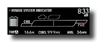

  14. lensovet
    May 23, 2009
    2,615
    496
    Burlington, NJ
    i just want to point out that this is flat out WRONG. even in EV mode, ICE may kick on and EV LIGHT WILL STAY ON.
    The ONLY way to determine if your ICE has turned on is to look at the HSI display and look at the car icon in the center. if it is green with the letters EV inside, ICE is not running. if it is black with only a green outline, ICE is on.
    end of story.

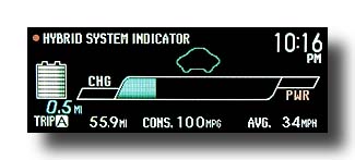

  15. john1701a
    john1701a Prius Guru
    Jan 6, 2004
    12,833
    5,310
    EV-Mode Engine Off:
    EV-Mode Engine On:
    rogerv and lensovet like this.
