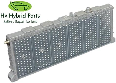

    A complete battery assembly that incorporates the cell-to-cell connectivity could be made as a single, integrated part. Redundancy to work around a single failed cell would be no more difficult than what we have today. For example, this is a six cell battery assembly:
    The open top, cell-to-cell, limits the maximum voltage. However, closing each cell is trivial and allows higher terminal voltages. There remains a non-trivial problem of thermal management channels. Cell chemistry is the next challenge.

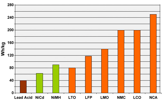

    NCA has twice the energy density of LFP. For vehicles, weight is key and higher energy density is always more desirable. For stationary battery systems, LFP would be fine.
    So I can imagine a single battery body with circular cell holes closed on one side. A machine rolls and inserts the "jelly roll" into each cell hole in a single block. A parallel, 20 cell, group would lose only 5% of the capacity should one cell fail. The top cover would then seal them to complete the pack. Then thermal management is the next challenge.
    Rivian claims they can achieve adequate thermal management from the end of 21700 cylindrical cells. Although it could work, the problem is the limited surface area to pass the heat. IMHO, cooling channels should be part of the block as passage holes.

    This came up in another thread. Tesla's choice here has nothing to do with which has a technical advantage. It is about lower cost, and not straining their 21700 supply for the Chinese market. These are only going into the Model 3 SR there, no where else. LG Chem is also supplying some batteries for this market, with the majority being the 21700 from Panasonic.
    LiFe isn't a poor chemistry; it just isn't the best for cars. While lower energy density, they are also longer life and safer. I would not be surprised with Tesla using it for stationary power supplies in the future.
    China has been using LiFe in EVs for years now. Most of their EV buses uses them. With the available space in the Model 3 SR's floor, they should work well for the target range. Tesla will also get to study CATL's moduleless technology.
