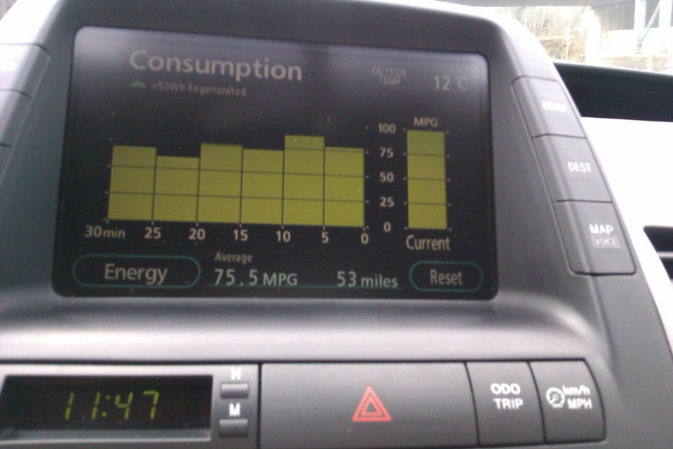

    Had a long motorway drive the other day, air con off, cruise control on for most of journey. Decent weather, UK gallon (4.55 Litres), reset MPG monitor some way into journey while doing about 65 mph. 53 Miles later, without stopping, my average was 75.5 MPG. I did drop my speed to around 55 mph just to see how high I could get my MPG.

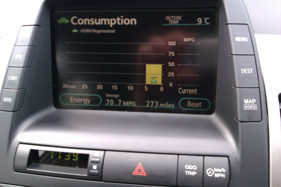

    Arrived at destination parked for about 3 hours, then returned home covering 273 miles (some slow traffic and didn’t go over 80 mph) from reset, averaged 70.7 MPG. I didn’t think this was possible, seems a lot better than official figures would even suggest. I thought maybe the meter was faulty but it seemed to be about right what with fuel used and distance travelled. I’m not complaining but wondered if something could be wrong, e.g weak fuel mixture or something. Any thoughts?

    75 MPG-uk is 60 MPG-us

    I think 62.4 US MPG equivalent

    70.7 miles/Imperial gallon = 58.9 miles/US gallon
    That is quite good, and if the check engine light is not on then you don't have to worry about the air/fuel mixture.

    There is continuous monitoring and adjusting of the mixture, so your good MPG is due to being in the sweet spot of temperature, terrain, and speed. Add some large hills, cold or heat, and the frantic pace of US interstates, and MPG's will reduce. (I don't know about your M-ways and speed limits, and how they are ignored.)

    Don't overlook the fact that he is resetting while the car is moving on the freeway after the ICE is warmed up. I bet if he reset with a cold ICE and then drove those routes, he would NOT get those kind of numbers. Just my opinion for what it is worth.
    The following is copied and pasted from the OP first post - reset MPG monitor some way into journey while doing about 65 mph

    The 75MPG is probably a little higher than actual because of cutting out the warm up crappy mileage by resetting during the drive (depending on when it was reset). The 70MPG should be pretty accurate, 270 miles plus the warm up for starting the drive back would largely make up for not having the first warm up included.

    60 mpg(us) at 60 mph is expected. Anything more than very little driving at 80 mph should have dropped the average down fast. BobWilson posted mpg/mph studies a few years back for anyone curious enough to track the PC thread down.

    However be aware that if you have the OEM size 195/55/16 tyres fitted the MFD calculation is about 3 MPG optimistic. Changing tyre size to 205/55/16 cures this optimism and the MFD then reads virtually spot on compared with millage calculations using fuel added.
