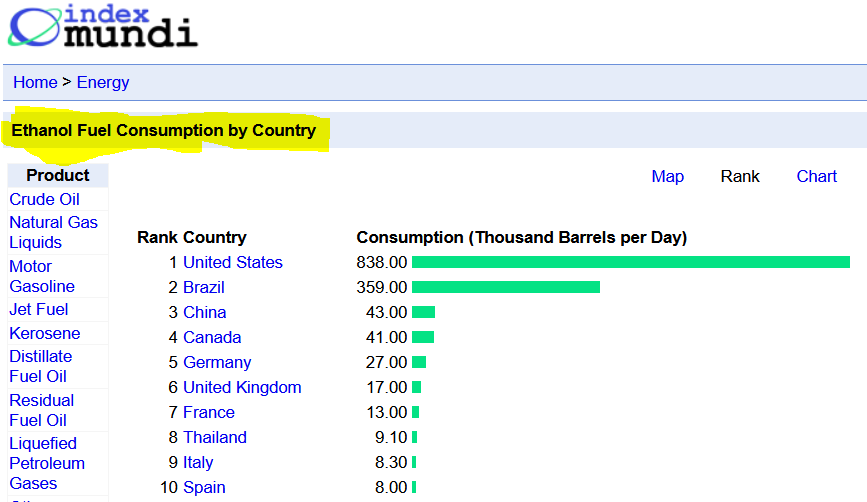

  3. fuzzy1
    17,715
    10,451
    Since you seem unable to look up Brazil's population or do the arithmetic to compute per capita numbers, I'll do it for you. Brazil has about 211 million people, vs. 328 million in the U.S.
    From the chart I posted, that means the U.S. uses (838,000 / 328 =) 2550 barrels per day per million people. Brazil, (359,000 / 211 =) 1700 barrels/day/million-peeps. I'll let you portray 1770 as "far more" than 2550, it fits your common argument style.
    You also used the plural form, meaning other parts of the world using more ethanol that does the U.S. Where else, beside your questionable claim of Brazil?
    Maybe China? :ROFLMAO:

  9. sam spade 2
    sam spade 2 Senior Member
    Mar 31, 2018
    7,035
    2,802
    2017 Prius c
    I admitted that I was not accurate in my last post.
    And yet you continue to rant.
    I am sorry that you take inconsequential things so seriously.
    Have a good day.......and stay safe.
