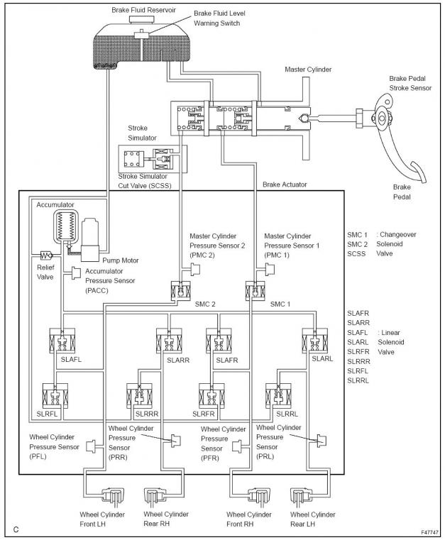

    Most older cars I'm used to, when you press the brake pedal, your foot manually supplies the hydraulic fluid pressure through a master cylinder to a slave cylinder in order to clamp the brake calipers closed.
    Is this also true for a Prius? I remember reading somewhere that Prius engineers went through an extraordinary amount of trouble designing their electric brake pressure pump for reliability because there was no actual mechanical/hydraulic connection between foot and brake.
    If ALL electrical power failed on a Prius, would the brakes still work?
    My ABS VSC and (!) circle lights are on and I want to know just how big a risk it is to move the car on the road.
    Do those lights mean I can lose brake line pressure, or just that my antiskid computers aren't working?

    In normal operation, the fluid you push in the master cylinder is not going to the wheels: SMC1 and SMC2 are closed. The fluid is going into a stroke simulator (SCSS is open), just a cylinder under the hood with a piston and springs, made to feel the same as if you were braking.
    Pressure sensors PMC1 and PMC2 measure the fluid pressure that you are generating in the stroke simulator, and that is the input telling the brake ECU how much slowing you want.
    The brake ECU asks the HV control ECU how much slowing can be done through the powertrain. The HV control ECU replies with an answer, the brake ECU subtracts that from the amount of slowing you wanted, and applies hydraulic fluid through valves (those SLAxx and SLRxx valves) to do the rest.
    If the brake ECU loses power, or loses confidence in its own sanity, it will drop power to all the valves. SCSS will drop to its normally closed position, so your foot pressure is no longer wasted on the stroke simulator, and SMC1 and SMC2 drop to their normally open positions, so the fluid pushed by your foot acts directly on the two front calipers, and only there. (In this fail-safe mode, the rear brakes are out of the picture.) You will have to press super hard, as there is no boost action in the Gen 2 master cylinder.

    By federal passenger car safety regulations, they must still work even when all brake booster power has failed. If they don't work, it is a defect for which the car should be recalled.
    But as Chapman pointed out, when power is lost and fail-safes come into play, you must press the pedal very hard, just like back in the old days of unboosted manual brakes. Put all your body weight or more (braced against the seat) into the pedal. Federal regulations specify a maximum (but long) stopping distance when the applied pedal force is 112.4 pounds (metric 500 newtons). Unless you have very strong legs -- it is best to use both feet -- you probably won't have a short stopping distance.

    By contrast, in Gen 1 and Gen 3, the master cylinder includes a boost chamber, and it will power-assist your fail-safe braking, so you don't have to push as hard, for as long as the accumulator pressure holds up. That can normally give you 20 or 30 strokes, which is pretty nice (the vacuum boosters on older cars would only give you 2 or 3, if the engine stalled and wasn't pulling vacuum). After you use up the pressure, you're back to having to press super hard.
    Gen 4 also has a boost chamber in the master cylinder, but its boost servo regulator is moved away into the actuator, and I've looked at that diagram till I'm crosseyed and I'm still not sure if it can give you any boost during fail-safe.
