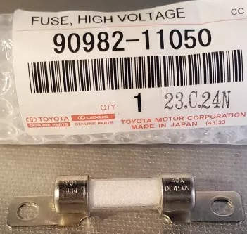

    Wow! You mean this one, right?
    I would never have guessed that one would be 40 amps. That would be over 8 kilowatts at 201.6 volts, and I've never seen the A/C exceed 3 kW. I might have guessed the fuse was 15 or 20 amps. But it sure does say 40A in that picture, doesn't it?
