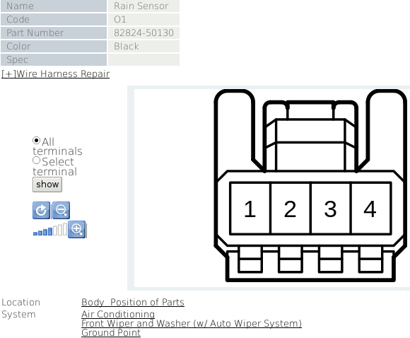

    So, in this other post over here, I go through how to find that information in the wiring diagram. Once you get to an image like this one (note this isn't A/C, just a different example):
    you see there is a link up in the corner, Wire Harness Repair. Click that, and the details of the actual terminal are shown (here, for confusion, is a different random example).
    That's telling you this (example, not yours) terminal would be a 0.64 mm size designation, in the second (II) family of that size, and of a non-waterproof style. (When you find your compressor terminal, it will surely be a waterproof style).
    You can compare those specs to other connectors in the car looking for terminals to cannibalize, but it's usually easier to go to the dealer and ask for (in this example) part number 82998-24290 and have them sell you the exact terminal, already crimped onto (in this example) a 160 mm pigtail of wire that you can crimp to your harness (in this example, you could use the 82999-12020 blue crimp sleeve).

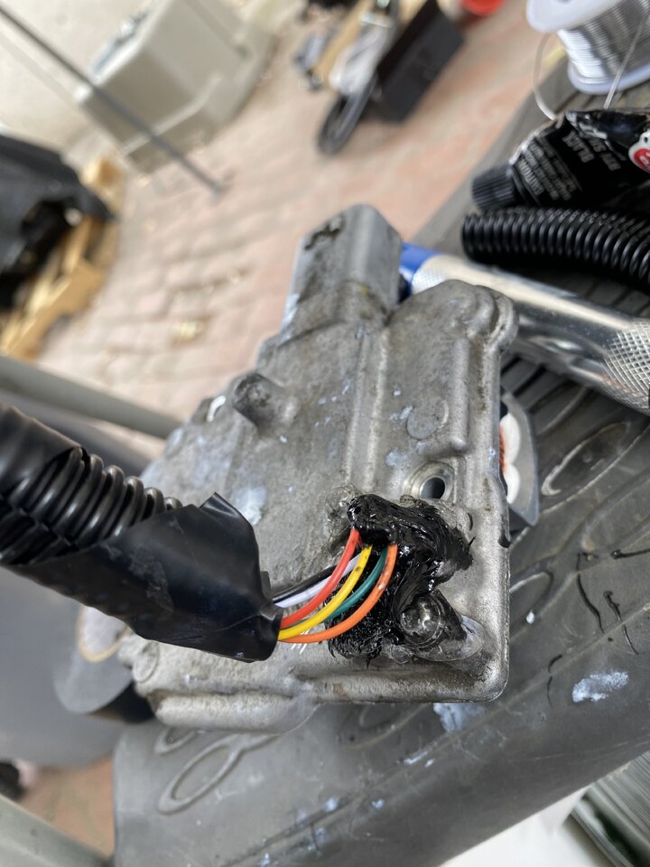

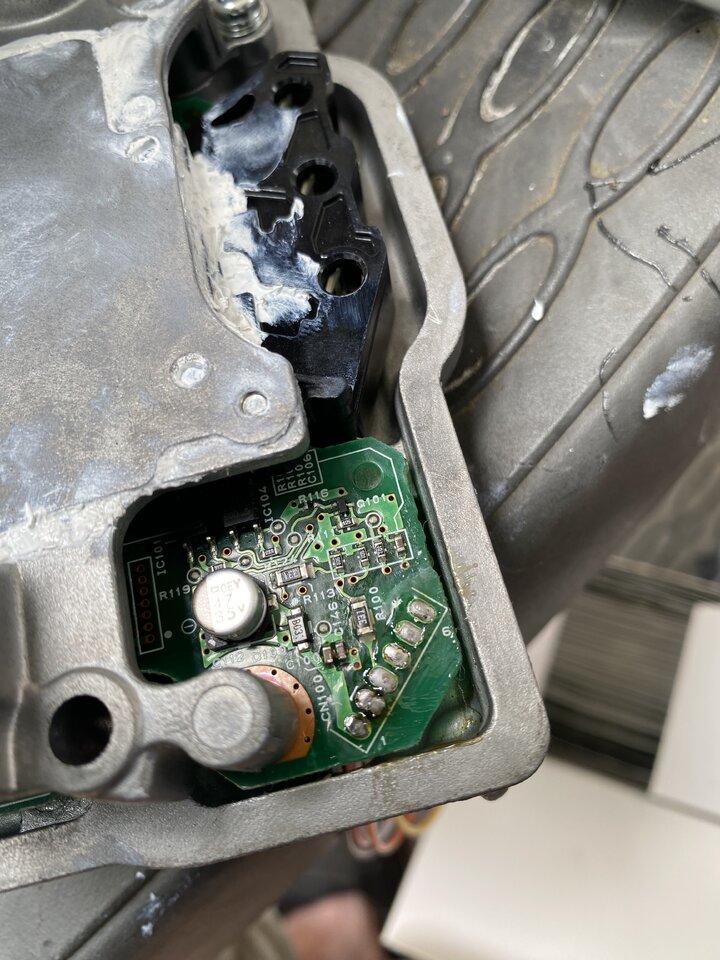

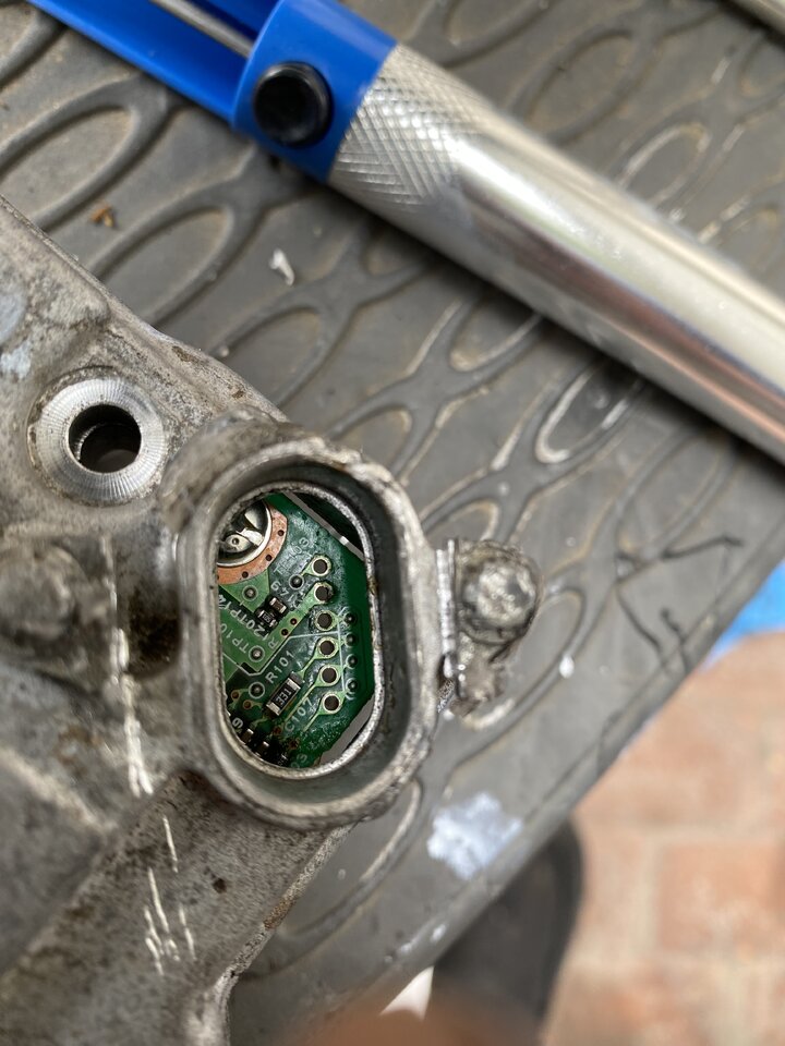

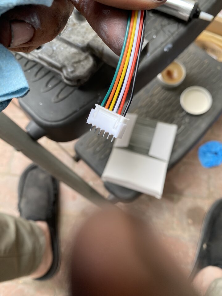

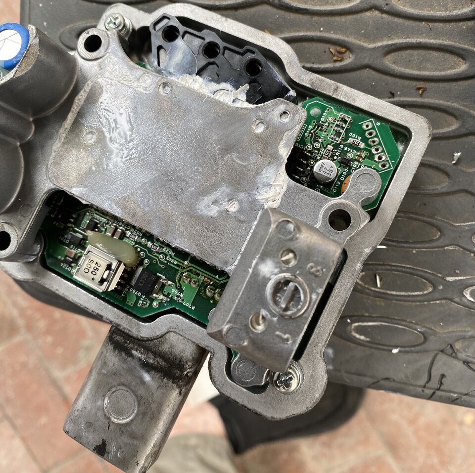

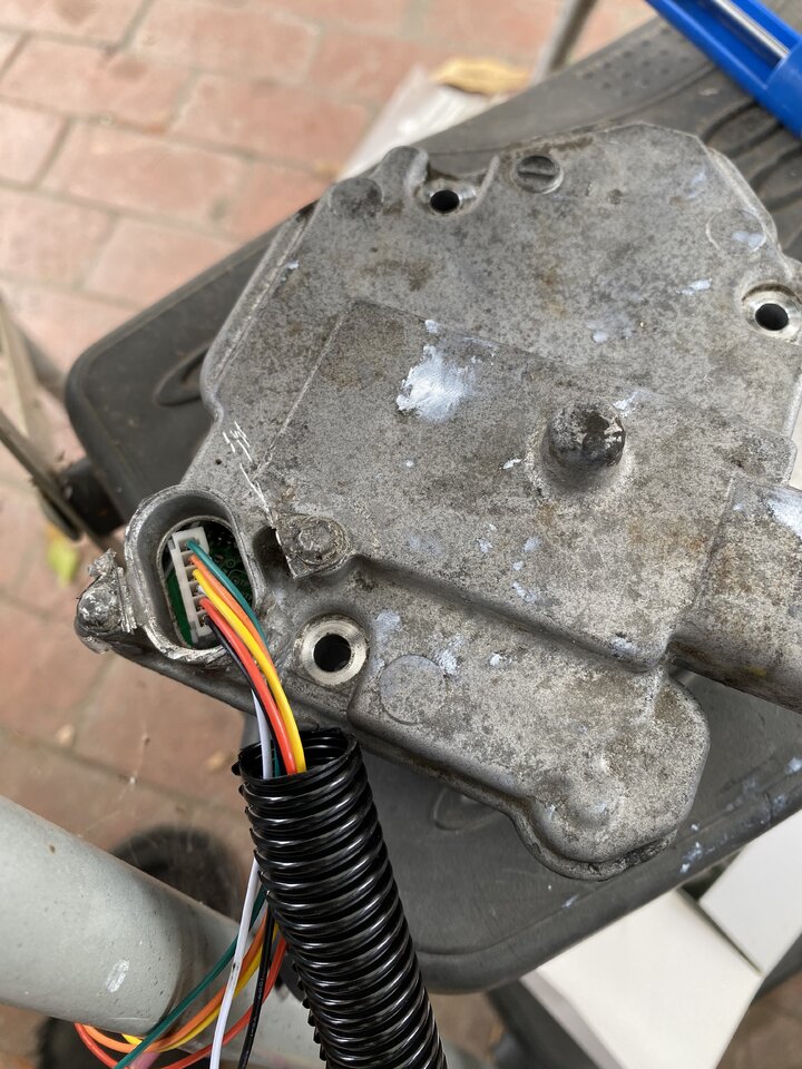

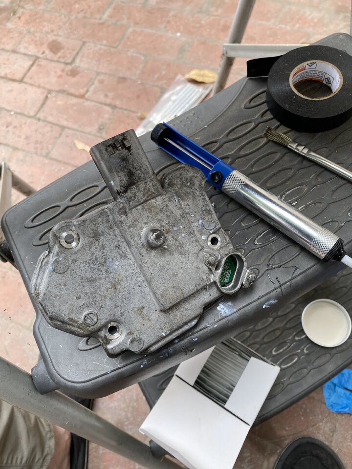

    IMG_4957.jpeg IMG_4958.jpeg IMG_4959.jpeg IMG_4960.jpeg IMG_4961.jpeg IMG_4962.jpeg IMG_4963.jpeg Hello, I wanted to post my experience on this topic. I had an issue with the pins being broken on the ac compressor. I could have gotten another one, but my curiosity got the best of me and I wanted to see if it was possible to fix the connector…I was hoping it was as simple as some wires inside I could connect to a new harness. Turns out it was a circuit board, I removed the top of the 12V side (the oddly shaped bolt heads were simply hex afterall), removed the solder and pins, and soldered in a new 6 pin connector. Then I sealed it up with high temp silicone and it works!
    Anyway, just wanted to share in case this may help anyone…

    Not advice, just sharing my experience. If you do try at your own risk, be sure to disconnect all power to compressor and allow capacitors to discharge

    Nice work. What did you use to suck up the solder? Did you do all this with the board still in the housing?
  16. refusedone
    refusedone Junior Member
    Jul 25, 2022
    40
    los angeles
    I used the device you can see in the 1st and 3rd pics, small hand suction device from HF. Yes, removed the top cover & had access to the front and back sides with the circuit board still attached to the lid.

    Just getting my bearings here ... I assume the part sticking out to the lower left in the photo is the connector for the incoming high-voltage DC, and the three circles in a row at the top center are sockets that connect to the three motor phase windings by just slipping over three internal contact pins? So, after removing the bolts, this assembly just lifted straight up off those pins?
    Is the space below this assembly open to refrigerant, such that imperfect sealing of this part when bolted back down would be a refrigerant leak?
    Or does this part bolt down onto a still-closed top compressor surface, with just the three phase winding pins sticking up?
    Are those traces of thermal interface paste I see around that flat central area, where it might be clamped against a flat compressor surface that's cooled by returning refrigerant? If so, what kind of paste did you use when reinstalling it?

    Yes you’re correct, the twelve volt PCB side is separate from the refrigerant/high voltage side. So the three pins connect the low and high voltage sides, no exchange between the two aside from electrical via the three pins. I used the same paste that it came with, did not add more. Yes, lower left is the high voltage connector.
