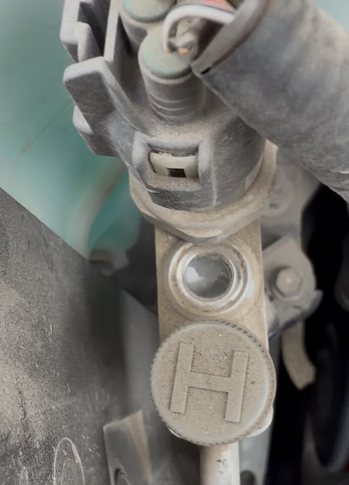

    Checking the basic ac is easy by looking at the sight glass on the passenger side right next to the H refrigerant access cap. AC running max you should see liquid refrigerant moving without any frothy bubbles.
    This pic shows white frothy bubbles on the top two thirds of the sight glass with liquid on the bottom. It is low. This one still worked but needed r134a pure refrigerant (no oil no sealer no dye $10 walmart can)

    RJ, thanks for your suggestions and your picture. I cleaned off the sight glass beside the "H" cap and put the a/c on max... the little window is completely full of what appears to be a steady stream of 'white' fluid that has so many tiny bubbles that I would describe it as dense shaving cream moving rapidly through the tube... I reckon that means I need to top off the coolant...

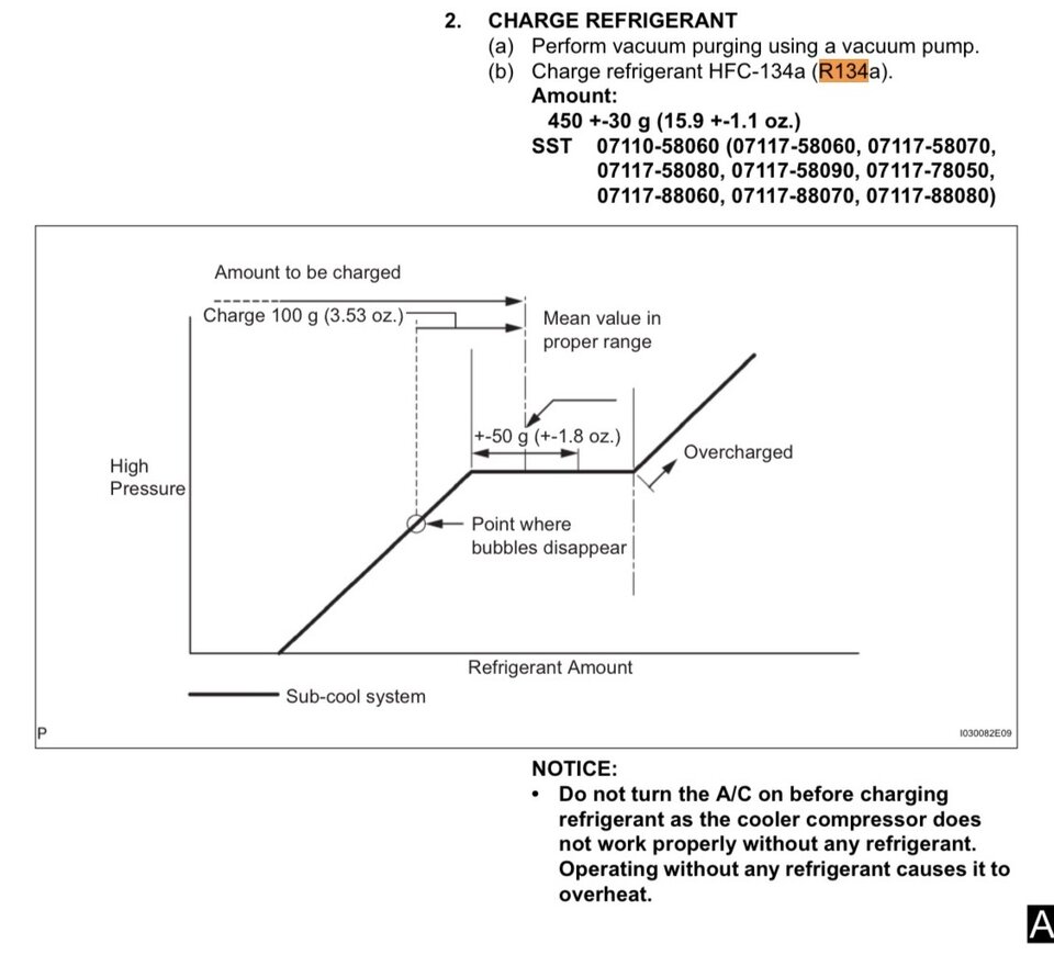

    Because the Prius uses a subcooling design, the sight glass clears of bubbles a bit earlier than the proper charge.
    They specify to continue adding—using a scale—100 g past where the bubbles disappear, though hitting anywhere 50 g to 150 g past is "good enough".
    However, many of us, including me, who's just some guy, and Tom Lech, who may have been our most knowledgeable A/C tech while he was posting here, have all found the sight-glass method to be so variable as to not recommend relying on it at all, but rather just to evacuate the system and charge the right known amount of refrigerant by weight.
    Some of Tom's threads about that.

  11. ChapmanF
    28,615
    18,950
    I guess to me that would seem like a safer strategy if it came with a disclosure that it's definitely stopgap advice for someone who might not take the time to do it right, and the advice is going to leave the system at best 50 to 100 grams undercharged. The risk of just saying "Fill until sight glass just clears and stop" is that it can look like that's the real story, not just to the OP at the time, but to every later reader who comes along and finds the thread.
