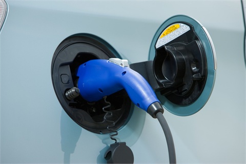

    We've had a lot of rain here in Virginia lately. Almost every morning, I find that water has pooled inside the charge port, since the car is not in a garage.
    If you live further north, you might find that rain or snow will also pool inside there during winter, and may even freeze :eek:
    This could cause some unforeseen problems.

    once built up a bit water will spill out of door opening so can only pool so much. its designed to charge inside or out, rain or shine so I would not be too concerned.

    isn't the charge port covered by a special molding in the door that closes over it?

    Yes it is, there are also drain holes as well. This is a non issue.
    The biggest issue could be during freezing rain/sleet sticking to the charging handle, making it a challenge to remove.

    Depends what you mean, when charging there is no moulding covering the area
    and the does does nto close when charging. (the port is well protected when closed and not charging).
    Looking at the angle I can see how water might get in there (but never into the actual "hot" area of the EVSE because of the way the plug works with double baffles).
    But even a few drips falling/splashing as one unplugs could cause problems. (I've read of both leaf and volt's where people got water into the EVSE. The circuit will protect itself, but will not charge in that state).
    I think the bigger issue might be freezing in place.. but if the charge is delayed the resistive heating inherent in charging should keep it reasonably above freezing in VA. (Maybe not fargo).

    My point exactly - the plug freezing in place, or ice preventing the hatch to close properly.
    I'm not worried about water inside the connector or receptacle. Still, I'm thinking of making something to cover the port while charging.
