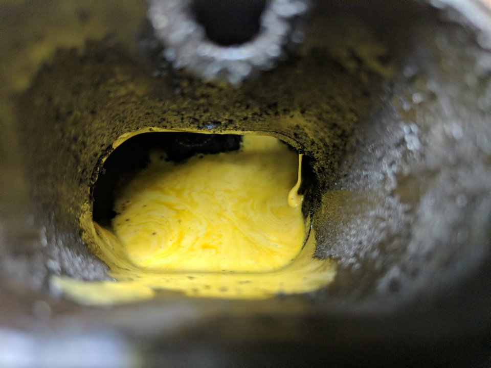

    3. What on earth is this substance? While I was cleaning EGR soot out of the intake manifold, I flipped it over and this stuff started dripping down into it. IMG_20220127_131657.jpg
    And for that matter, how do I clean it all out of the intake?

    Some coolant mayonaise? How long have you had the car; could someone have added a stop-leak product?
    BTW: how many miles on it?

    Coolant mayo - that's a good way of putting it. Yuck.
    We bought this car in known broken condition - previous owner was honest about it overheating, which was not from gradual deterioration but from him removing a coolant line to replace a headlight bulb and forgetting to put it back. The engine compartment showed evidence of coolant spraying everywhere. He had tried adding some coolant but did not say anything about stop leak, nor was there evidence of any stop leak elsewhere.
    It has 104k miles. EGR was certainly ready for a cleaning but was not as bad as some of the pictures here of completely jammed EGRs.

    Brake cleaner and rags. Various diameter bottle brushes are good too. Skinny brushes (the kind used for cleaning gun bores or steel drinking straws) are especially useful for the Exhaust Gas Recirculation capillaries. You can see one at 12 o’clock in your pic.

    The gunk in your picture looks a lot like moisture contaminated oil which given it's winter and you're in PA I would not worry about it.
