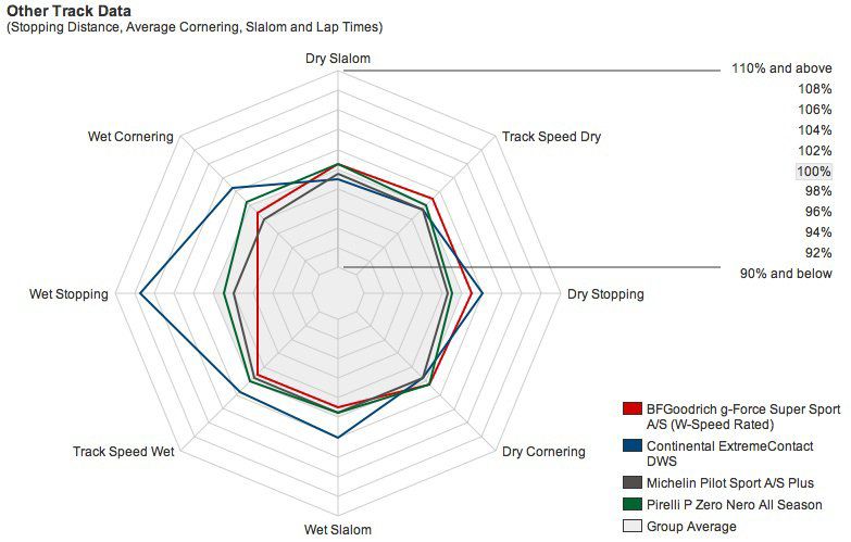

    I've probably over-quoted this article only because it accurately lays out the problem owners face when choosing a replacement tire. Car owners can't find credible sources of the "spider chart" described in the article nor specifications of the vehicle metrics that impact the tire specifications needed. With nine years of 2003 Prius ownership, 120,000 miles and four sets, and five years with a 2010 Prius and two sets, I've 'back ended' to some of these metrics.

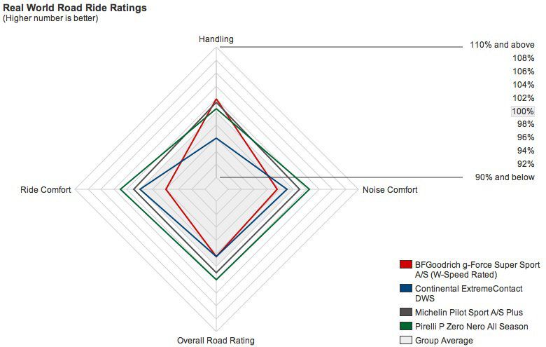

    Gary mentions the 'spider chart' and Tire Rack does publish theirs such as these examples:
    and

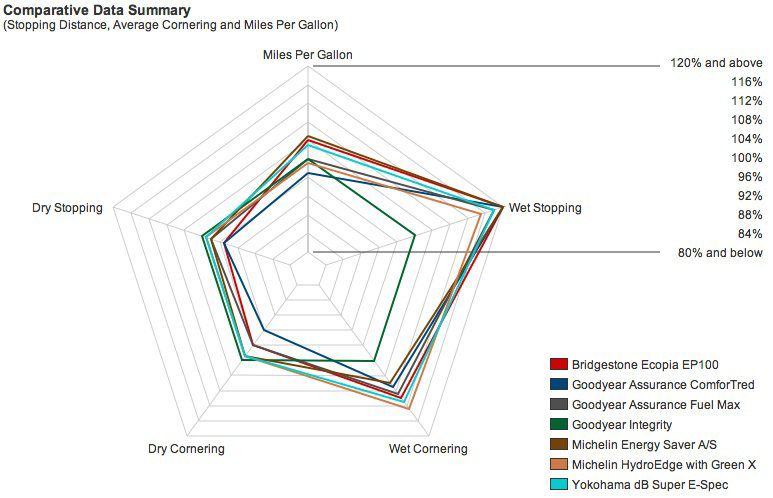

    I appreciate the charts were published BUT where is the rolling resistance metric? Well here is one from Tire Rack:
    That Tire Rack publishes something is better than nothing. At least they are trying to give us some metrics . . . FROM 2009!

    Nice examples of spider charts!
    Also wish we had current objective comparative info.
    Surprised Consumer Reports does not use this method to convey comparative tire information; it is very efficient.

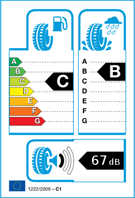

    In EU all manufacturers have to mark tires produced after July 2012 with roll-resistance, wet cornering and noise ratings by law. Labels are standardized like this one for Dunlop SP Winter Response 2:
    Do try some online Europe shops just to find the tire model you want. Then check if you can buy them in USA.
    Here's my query for PiP 2014 winter tires ordered from lowest to highest LRR at ReifenDirekt (in German language).
    As you can see winter tires hardly gets better rating than C for LRR.

    Just more evidence that consumers need better labeling.
    The EU ones are straight forward and easy to read. A tire on one of the posted spider charts has a worse dry traction rating than it's wet. So maybe a dry traction label would also be called for.
