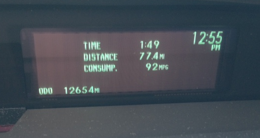

    For me there's at least one clear situation where my PiPA gets better fuel economy over a standard Prius. This is when there is a long downhill grade on drive that generates more than a standard Prius battery can hold. When the standard Prius battery becomes full with regenerative charging, the engine starts. Moreover, you really don't get any EV from that full battery.
    On the other hand, with my PiPA I've been on some downhill grades that have charged well over 7 miles worth of EV and the engine does not come on. This is where the PiPA shines when driving beyond the original plug-charged range. I'm posting a picture of an example. I few weeks ago I drove home from Yosemite and was able to charge up my battery several times with alternatively downhill (charging) and flat (running on mostly EV) terrain. I left Yosemite with nearly no EV charge on the battery. 77 miles later I stopped for lunch. It was a beautiful and mostly silent drive!
