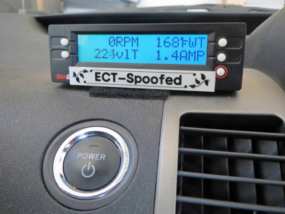

    My ECT Spoofer (by Winston) -- a birthday gift from my wife -- arrived in a perfect little installation kit with color-illustrated instructions, helpful PriusChat links, and an “ECT-Spoofed” decal (now on my ScanGauge II).
    It’s a beautiful little unit in a tight, tidy case. It works exactly as described, and the handy color LEDs keep you fully informed. (Mine now hangs below the glove box).
    The climate is mild in Phoenix and my commute long and fast, so I did not expect any real improvement in consumption. Yet my indicated (MFD) mileage (on only 450 miles since installation) appears to have increased from 55 to 59.
    Better still, Mr. Spoofer speeds me to Stage 4, keeping the engine off when I’m coasting & mildly motoring on nearby long, gentle downslopes. I love the increased sense of control. I have 80K on my ’06, and it feels like a new car.
