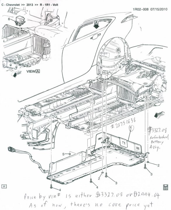

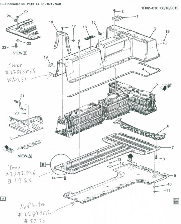

    The item labeled as "1" on the diagram and named a "battery" in the table is actually a battery tray.
    - Alex
  9. El Dobro
    El Dobro A Member
    Jul 12, 2011
    7,106
    3,282
    No, it's a complete battery.
  10. Trollbait
    23,744
    12,832
    That is what I thought it was from previous discussions on this topic, but what hazardous material would a battery tray contain? Just a mislabel?
    Swapping a pack appears to be plug and play. You could likely do it yourself with a transmission or motorcycle jack and some jack stands. Presumably, the cost of replacing the entire pack will mostly be the pack itself. Out of warranty, the owner might want to save some of that by just having the faulty modules or cells replaced. The labor cost I was thinking of was that involved in digging into the pack to do so.

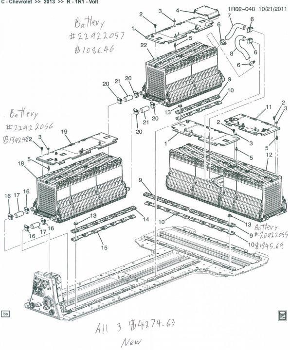

    You can buy the entire unit #1, or you can buy the 3 modules seperately for around $1000 each. I don't know where you can get the seperate cells.

    The thumbnail below is fron a GM catalog, not one that's online. It shows the battery assembly, which is a refurbished unit. It's complete and ready for installation.
    This thumbnail shows the cover and associated parts. It's not available as a complete part.
    This thumbnail shows the battery modules. They are new.

    The pricing makes sense then with it being refurbished. Only the bad cells or modules were replaced.
    According to the thumb nail for the modules, a new battery will be $4275 plus the cost of getting them installed in the case.
