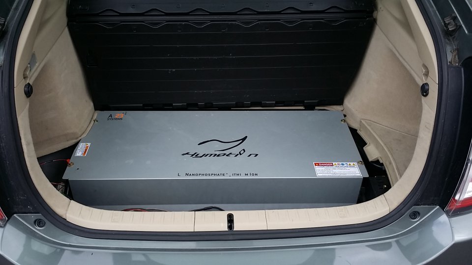

    I just purchased a 2004 Prius from a Canadian Government Surplus auction a couple of weeks ago. What made me curious about the vehicle was the fact that it was advertised as having a second battery installed.
    Turns out the second battery is a Hymotion Lithium Ion battery pack!
    I took a little bit of a risk as these types of sales are "as-is" and the Sales rep had no documentation for me except the original manual that came with the vehicle.
    Of course, because sometimes life is just like that, the battery doesn't seem to work. I can plug in the battery and the back lights do actually light up, but after charging it for 12+ hours, when I flip the
    PHEV button nothing happens (the display doesn't change, the button doesn't light up, and the engine still runs as it normally would). The odd part is that when I do slip into this mode, my SOC battery seems to drain very quickly (from 6 bars to 2 bars in a little under 10 minutes), and two beeps sound off before the gas engine turns on to recharge the battery.

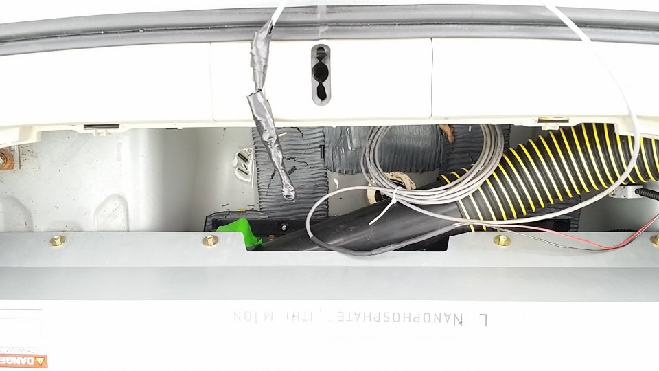

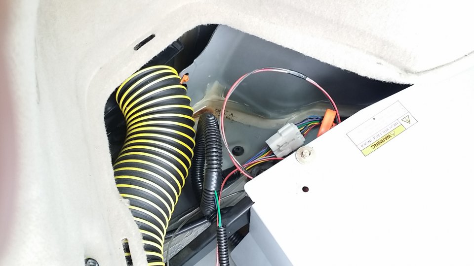

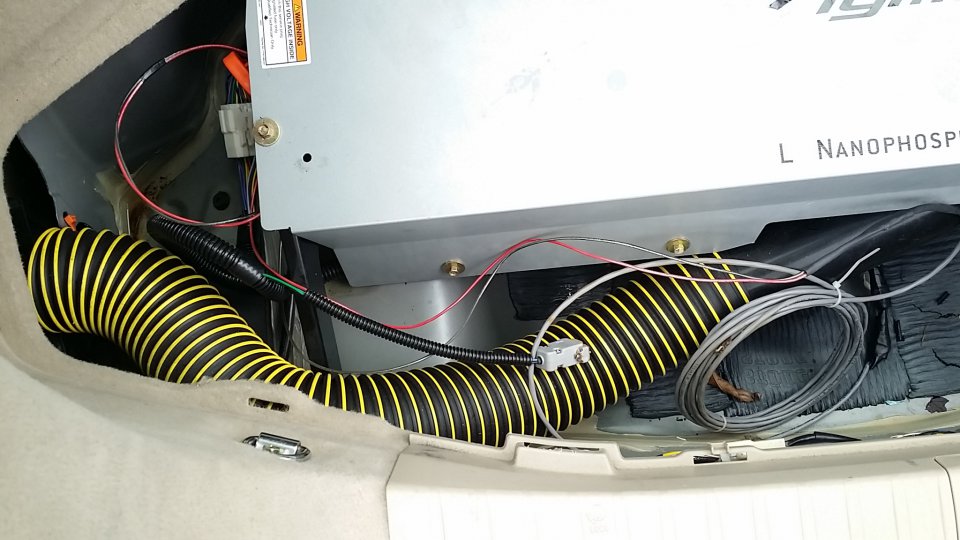

    One of my good friends is actually really into this stuff, and he's been trying to help me find documentation about the installation. He believes the battery might of been disconnected (see pics below) which may be causing the problem.

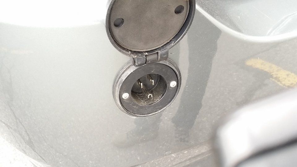

    When I plug in the battery, the only reaction from the car are the brake lights turning on. They seemed to be on at full intensity the entire time I attempted to charge it (I had heard that as the battery charges the lights dim progressively until they eventually turn off). No dash activity either.

    Generally the tail lights should come on when plugging in, and then either dim or go out completely.
    Do you hear the fans coming on when plugging in? Does the cord get warm?

    No fans, and the cord doesn't get warm either.

    There are some basic things like checking fuses, inertia switch, dash switch, and service plug that I do whenever a system like yours comes in.
    Since yours does not have a separate trouble code indicator, and you do not have service hardware/software you will basically be flying blind. You'll have to systematically go through the components, ruling out things as you go.
