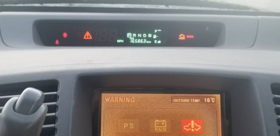

    After installing the reconditioned HV battery and a fresh 12 volt I have gotten rid of all the error codes but one. I have the PS light on with the lovely triangle. I ran techstream got back absolutely no dtc codes....... any ideas?

    Are you saying that the left icon is now lit up and the right one is now dark?

    Correct but all is well now no dtc or issues the PS was on due to a faulty connection that I have now resolved the car is officially road ready
