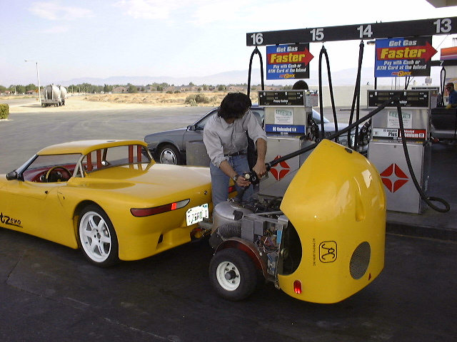

    Is that while it's depleted batteries are trying to be recharged? ... or on a fresh pack. So many variables ... such a high price ... such an unreliable company. They STILL want to sell you an internal combustian engine, at all costs.
    Why would I want a GM ICE. If I have an EV ... and absolutely positively HAD to go farther than 100 miles w/out recharging ... I could make up one of these puppies to tow behind my ride:
    THAT way, I'd be more comfortable, knowing I didn't have to rely on a GM ICE.

    Read this somewhere.
    Drive in your Leaf till battery depletion. Then switch to the Prius you have been pulling along, with Leaf hitched to the back. Repeat after every recharge ;)

    That picture is just SO WRONG!!! The EV that put all gas cars to shame, towing a gas engine. :mmph:

    Now now, Daniel . . . you know, you COULD just as easily have that trailer generator running on LPG or CNG ... and then? It really isn't too shabby an idea!
