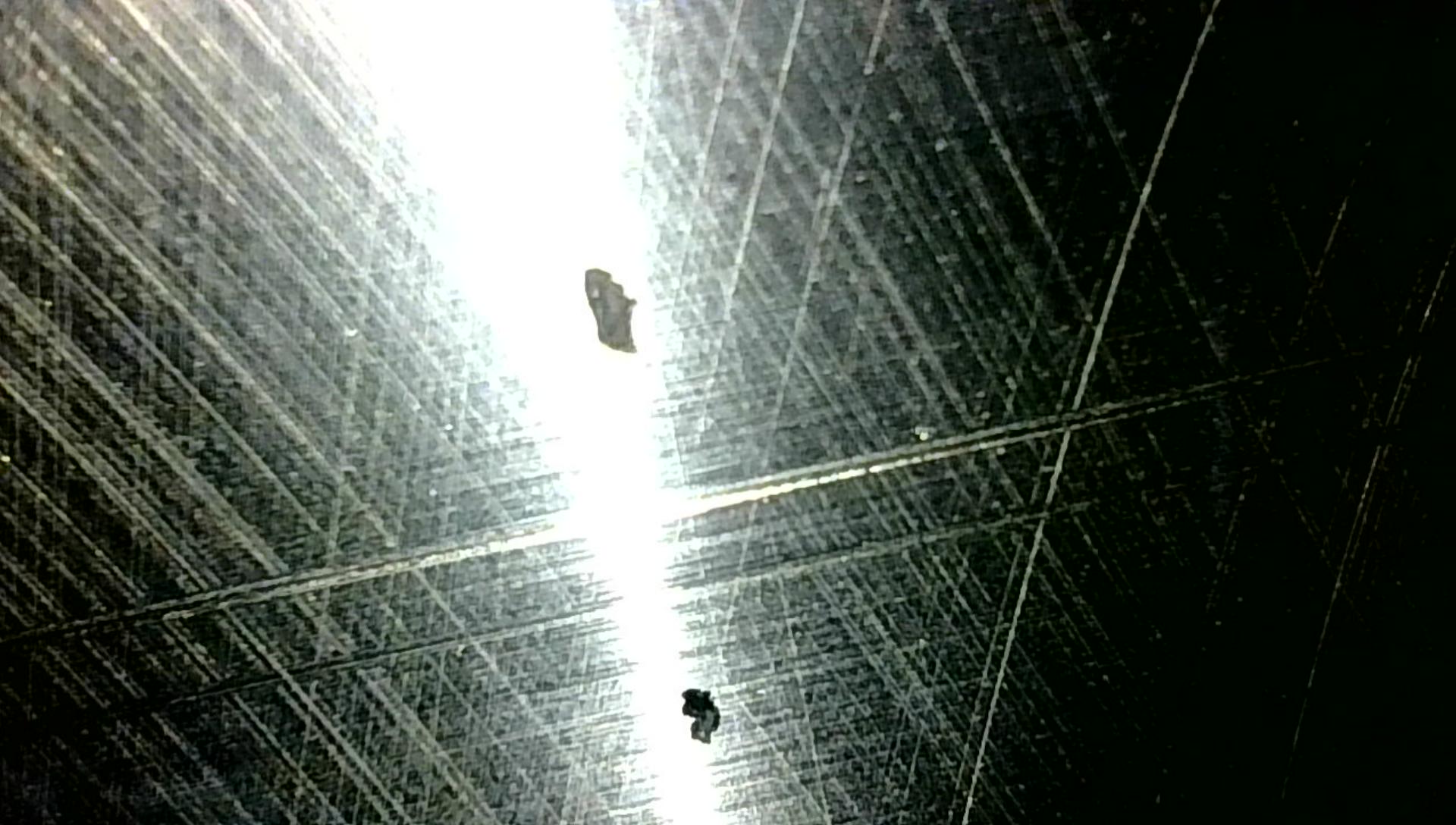

    Seized rings cause the engine to use oil. If your engine isn't using oil they are probably fine. Frequent oil changes can help prevent this. I scoped my cylinders and could see where the rings pulled chunks out of the cylinder wall. Not good!
