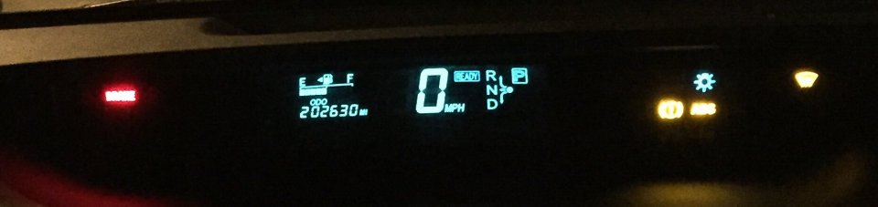

    Here is a picture of the lights.

    So I took it to a shop that had a obd2 reader, and no codes came up at all. Is this a good sign? Or should I try somewhere else??

    Not really any sign one way or the other. They probably do not have a Prius aware reader. Yes, take to another place.

    Yes, generic OBDII readers only query generic PID's, and not Prius specific ones. The blink codes method suggested will get the info directly from the source.
