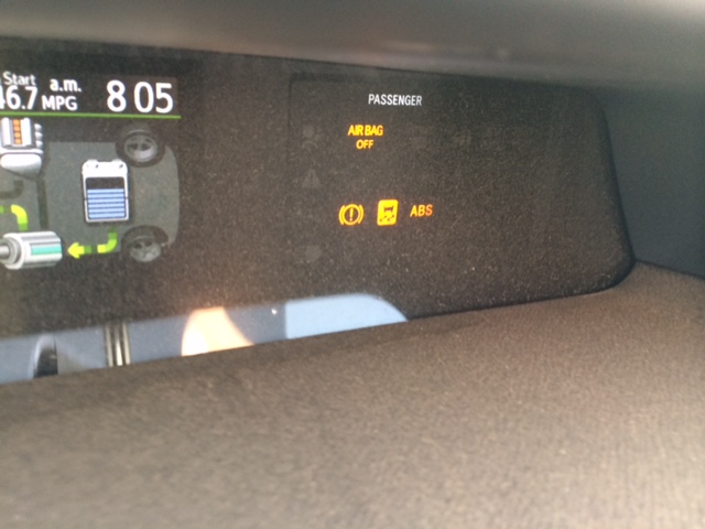

    I have the Prius C which when I bought had 3 lights on the dash - ABS, Brake System light and Slip Indicator light ON. Any ideas what this may be?

    I just got a OBD Scanner, and it shows the code C1464 - Front Speed Sensor RH Circuit. But the sensor looks good, no any damage or anything like that. Should I just replace the sensor? Or could be something else?

    I had the same thing happen to me a few weeks ago, however when I turned the car off and back on again the lights were gone and haven't come back. I took it to the dealership and they said they couldn't find anything wrong with the electrical or sensors.

    Thats weird. I changed Right Speed sensor, And nothing changed. Then i cleared the codes and light went away. So i guess for some reason speed sensor went bad. They are cost like $200 each. Crazy expensive for little budget car like Prius C.

    Lets revive this thread. I just had this happen to me! The three lights, (yellow !), Slip and ABS. I have to find my OBD and get the code. But I am still under warranty so hopefully it will be covered under warranty.
