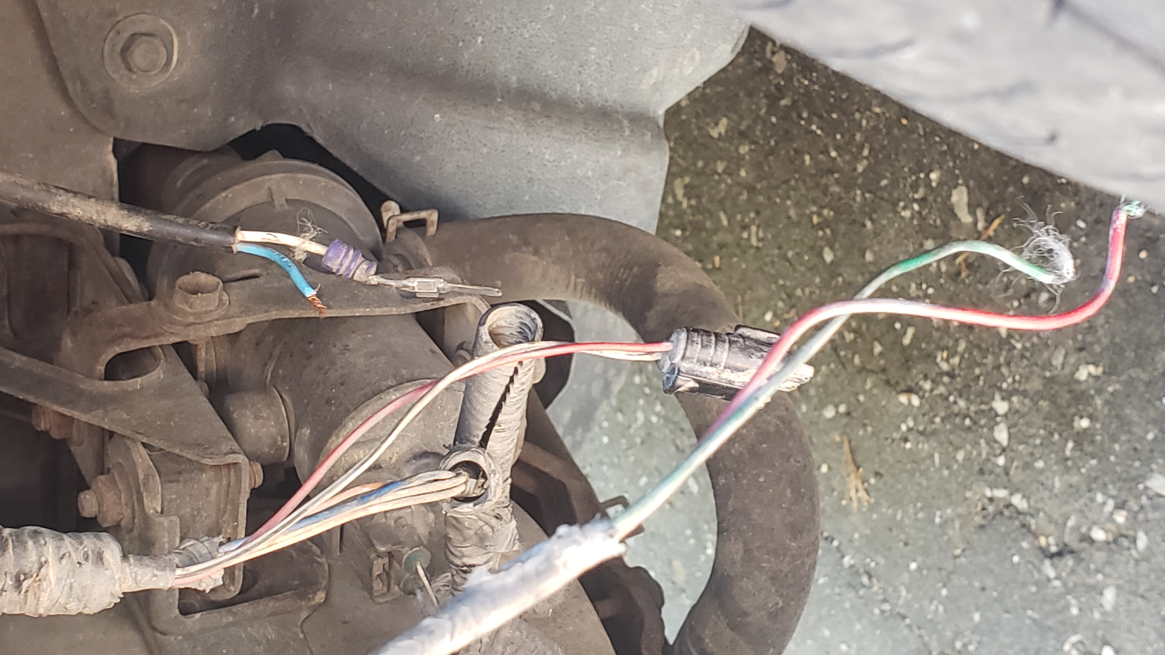

    New to Prius and the one I got the other day has some damage to the ABS wires and I don't know the color codes. The wiring I did find online does not match the colors, only the White and Light Blue match, so, is there a link to a 2007 Prius that will show how to connect this back up?[​IMG]

    I'm going to do some guessing here, that the blue and white wires go to the wheel speed sensor. If so, then connect the blue to the green wire that's hanging loose, then the white to the red.
    Ideally you'd find replacement connectors, but if it works, then just crimp them and "somehow" make it weatherproof.

    Rad, thank you the dash lights went off after a few miles.. Now to figure out what that other plug with the Red and White/black strip goes to.

    I think that should go to the "widget" that beeps when you press the lock-unlock button on the key fob.

    Now that you mention it, the car does not make any noise when I use the key fob. I would guess it just puts 12 volts on the circuit and the widget has the electronics and speaker that beeps. I will make a test light out of a led and resistor and see it if flashes.
    Thanks for all the help so far.
    EDIT: I went and found the part number and the connector on the buzzer is a match and you can see the tab or push tab that goes into the fender (not sure what the mounting part is called) Again thanks
    If someone else needs the the part number is:
    89747-AC010 Keyless Entry Warning Buzzer
