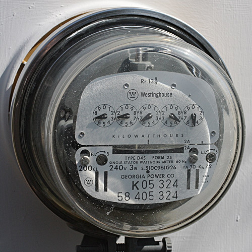

    Can anyone here say for sure whether an old-style spin-the-disk meter measures volt-amps or measures actual watts.

    Watts. In kilowatts, per hour. That's why it's called a kilowatt meter:
    So the above reads 72,666 kilowatt hours.
    Or, if solar panels are running the meter backwards, it'd be 27,335 kilowatt hours of surplus generated.

    I read that as 72664 (not quite 72665).

    Don't forget that dreaded Kh factor multiplier
