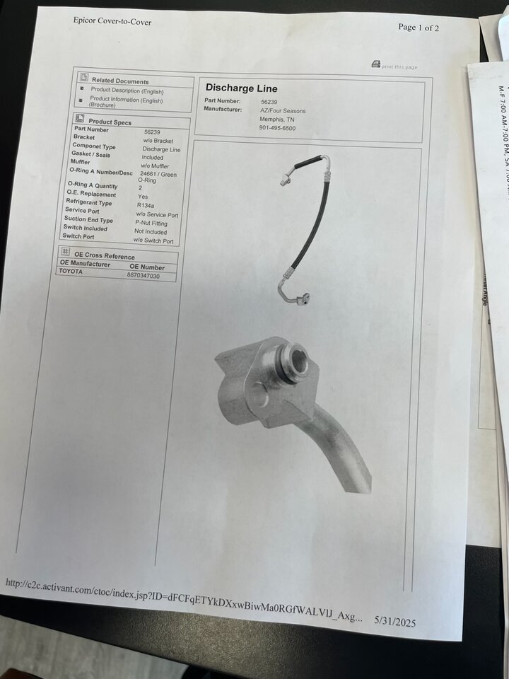

    Hi all. Wife was taking a trip and the fan rubbed a hole in the above hose. I assume this discharged and evacuated the Entire AC system since the AC no longer works. Weekend trip. 100 degrees in the car. Summer in Kansas brutal. She is 2 hours from home. I’m on a plane and can’t help. Tires plus quoted her $600 to repair it.
    I’m sure this is less that the stealership. I can’t work on AC systems. I gather this is a needed service work. I’m trying to get it scheduled ASAP. Thoughts? Price? Part? Job difficulty? Chap, RJ, this is not a basic home mechanic job. Correct?

    Just replaced one the other day . Very quick need the hose clamp tool 8 bux. I did on side of road purged and left cold . I may vacuum n down later on . But I'm ice cold . Hose already in car in package 44 bux in a bag .had o rings pre installed make sure they're not in cars fittings

    you can buy this hose in RockAuto for $16 to $44 plus shipping/tax. You can replace it yourself easily and have a shop vacuum (remove moisture) and charge with r143a. If you have a vacuum pump and a manifold gauge you can do it yourself, AC work is not rocket science. For better performance have the drier in the condenser replaced if it was left leaking for a long time.
