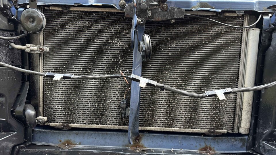

    Hi guys, little update. We went on holiday to Italy with the car and that was quite the experience. Out travel day was 34 degrees Celsius and the AC barely kept us from overheating on the freeway. It did something, but not even close to enough. Around our holiday address the maximum speed was 50 km/h, so AC was also of no use (not enough speed).
    Back some again, I removed the front bumper to find a condensor that is in a much worse shape as I first thought. I cleaned it as good as i can, straightend the fins, but a lot of them were very brittle/corroded. So in the end there was not much left of these fins. The cooling capacity after doing this did not improved, and may even be a little worse.
    Since summer is over, I'm going to ignore this issue for now. If this car is still with me next year spring, I think I'm going to replace the condensor and go from there. If any of you have other suggestions I'd love to hear them. Thank you!

    That condenser is ugly, but it looks like it still has about half its fins in working order. I would be more worried that the system is slowly losing refrigerant, perhaps through the evaporator, than that the condenser is beaten up. Anyway, while you ignore this issue I suggest not turning the AC on at all, lest you find one day that all the refrigerant has waved bye bye and running dry like that makes the compressor also shuck off its mortal coil.
