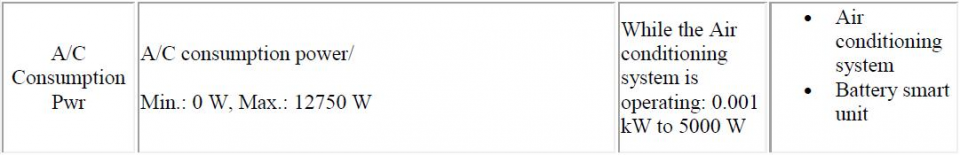

    Agreed, but the NHP10 and ZVW30 spreadsheets both show 17.098 HP / 12750 Watts. Perhaps Vincent1449p will see this and comment...

    I followed the same min. & max. values in Repair Manual:
    It show the mathematical min. & max. values and the actual operating ranges are shown in the remarks column, i.e. 1 ~ 5000W.
    Vincent

    Thanks for the clarification, VIncent!

    Am I missing something here ?
    How is that a clarification ?
    12,750 W is quite different than 5,000 W

    Probably...
    It's a clarification for me.
