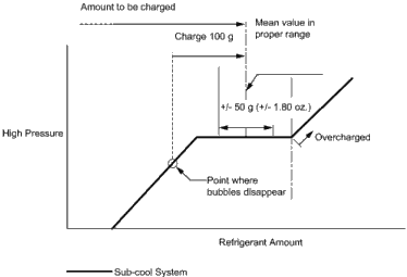

  13. ChapmanF
    28,721
    19,019
    I am not positive that you'd want to see bubbles during operation (unless operating in weather way hotter than the test conditions given in the manual).
    They like the system to operate in the sub-cooling region (where the slope of high-side pressure vs. refrigerant amount levels off for a while, before starting to climb again with an overcharge). That region starts a little bit past where the bubbles disappear; their standard charge should be about 100 grams past that point, and end up about in the middle of that sub-cooling area.
    When the A/C has been running and then stops, you do want to see a burst of some bubbles in the glass then; if it stays liquid, the system is overcharged.
    (This diagram is from a gen 3 repair manual, but I think the gen 2 details were pretty much the same.)
    But there seems to be a pretty good consensus around here that it hasn't been very helpful trying to do anything by the sight glass, and that evacuating the system and then putting in the right amount of refrigerant by weight is the more dependable way to go.
