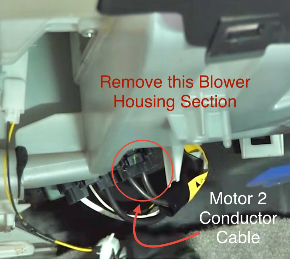

    99% it is your blower motor which is relatively easy to change from the passenger footwell. There is a snap in black cover first, a two screw ecu second, a five screw white blower housing next then the three screw motor.
    The new motor comes with the blower wheel. You can buy cheap aftermarket motors at local auto supplies for less the $50; it was used in many models. A better solution is the oem Denso part.
    Denso Blower Motor Sub-Assembly with Fan Part Number: 87103-47050
    Removing the glovebox is optional but you should change or clean the cabin filter.
    Top tip: When reinstalling the white blower housing be sure to route the motor cable in the slot in the back of the housing. Otherwise you will pinch the cable and may not be able to start the rear housing screws.
