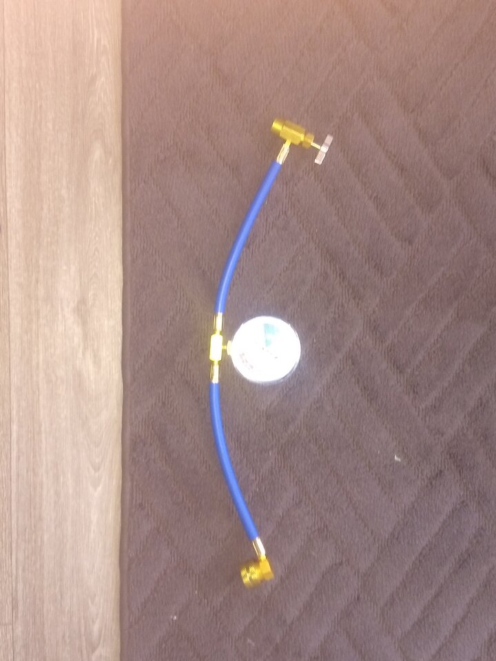

    There was nothing weird about this job. This was super straight forward example of an overfill. I wouldn't attempt this again picture of the tool attached. The correct way is a vacuumed and fill which isn't expensive.
    What is weird is AI behaving like a shady shop. A shady shop behaving like a shady shop.
    From my experience here in Las Vegas is that our indie shops are no good. Most of them never learned to work on a hybrid and dont have dedicated equipment. The national chain (PB) has dedicated hybrid equipment and ready to roll. I always been the guy to support indie everything. But in this case, with this car, and in this city its not a good idea. 300 inspection vacuum and fill and I have the coldest auto ac I have ever had. The 20yr old ac unit did exactly what it was supposed to do and protected itself from a boneheaded diy'er like me!
    I can't figure out who you prius chat techs are, why you do this, nor who pays you. RJParker do you have a tip jar? Thanks!
