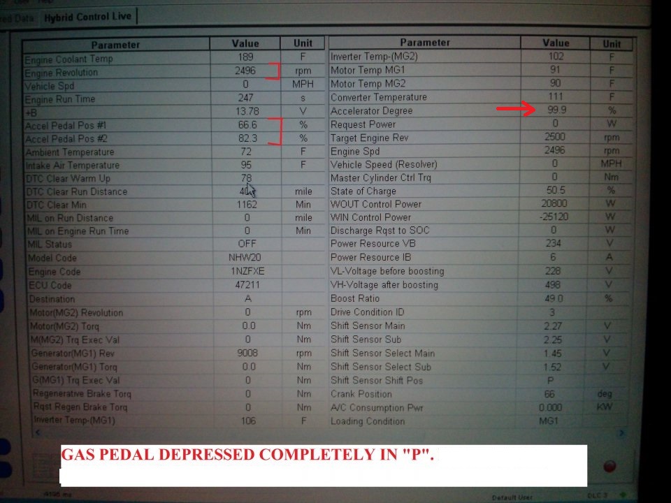

    Please check out the screenshots of techstream on my car. One is with foot off the gas pedal and another with foot completely depressed. On the left hand side you can see the 2 "Accelerator pedal sensors" and on the right you can see the % pedal depressed which matches with what I am doing, however the 2 accelerator pedal position sensor # 1 and # 2 don't match ever, even with the pedal not depressed # 1 is at 16%. After doing some research I found that these 2 sensors are actually located on the Throttle Body Assembly, so I went ahead and changed it with a used one but these numbers did not change at all, and the issues did not get fixed completely. Did I research incorrectly?

    480
    It looks like one of them has failed. Due to the redundant design, you're operating on the backup sensor.

    The throttle position sensors on the gen2 Prius are "hall effect devices" (a transistor that can sense the strength of a magnetic field). Many older cars use a potentiometer. Like all electronic devises they can fail, but they do not ware or suffer from bad contact in the same way that a potentiometer does with a wiper running up and down a resistance track.

    Your problem is more likely to be at the pedal end of the system.

    Aha! Will replace it and then check it again. Hopefully this eradicates the problem.
