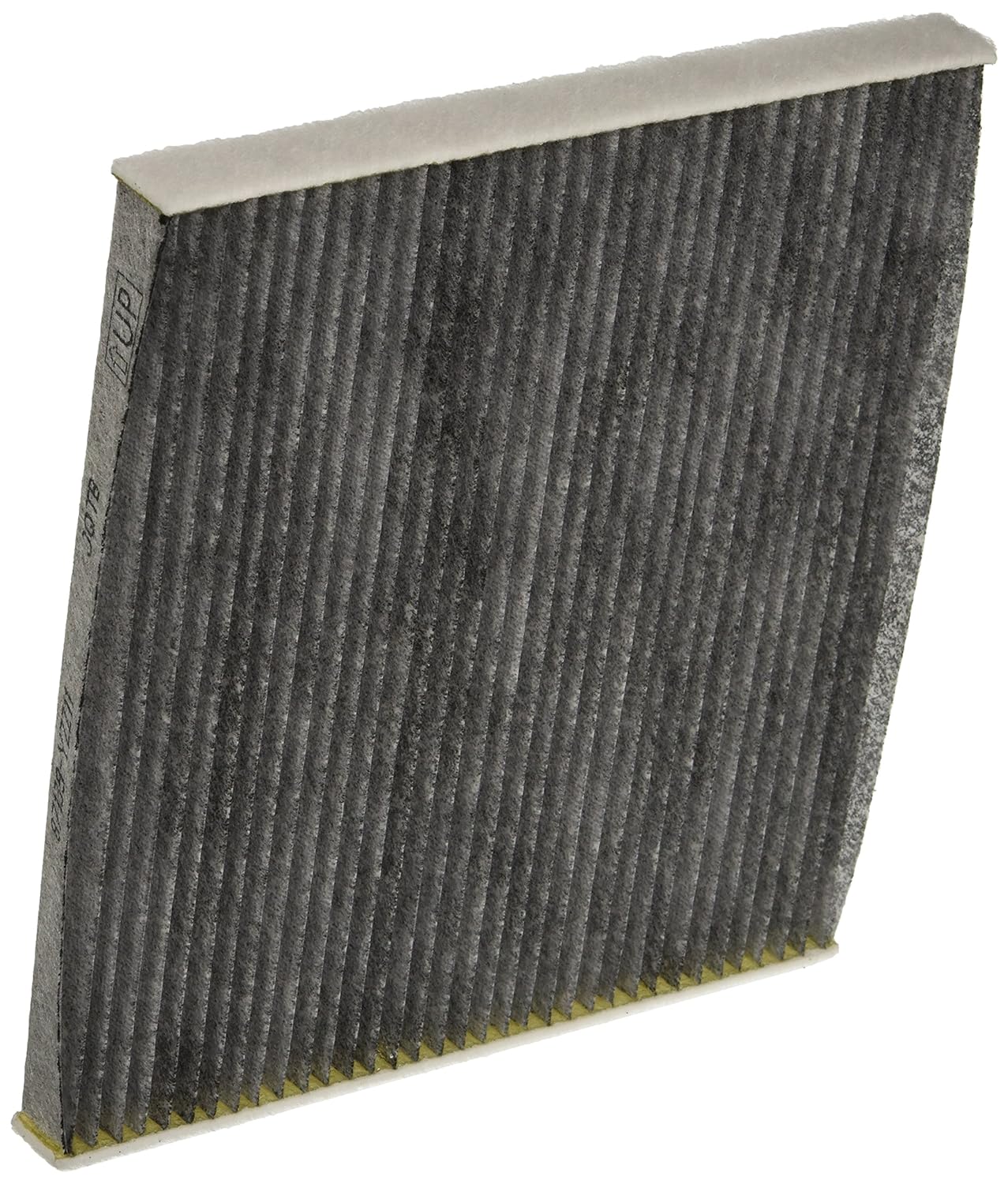

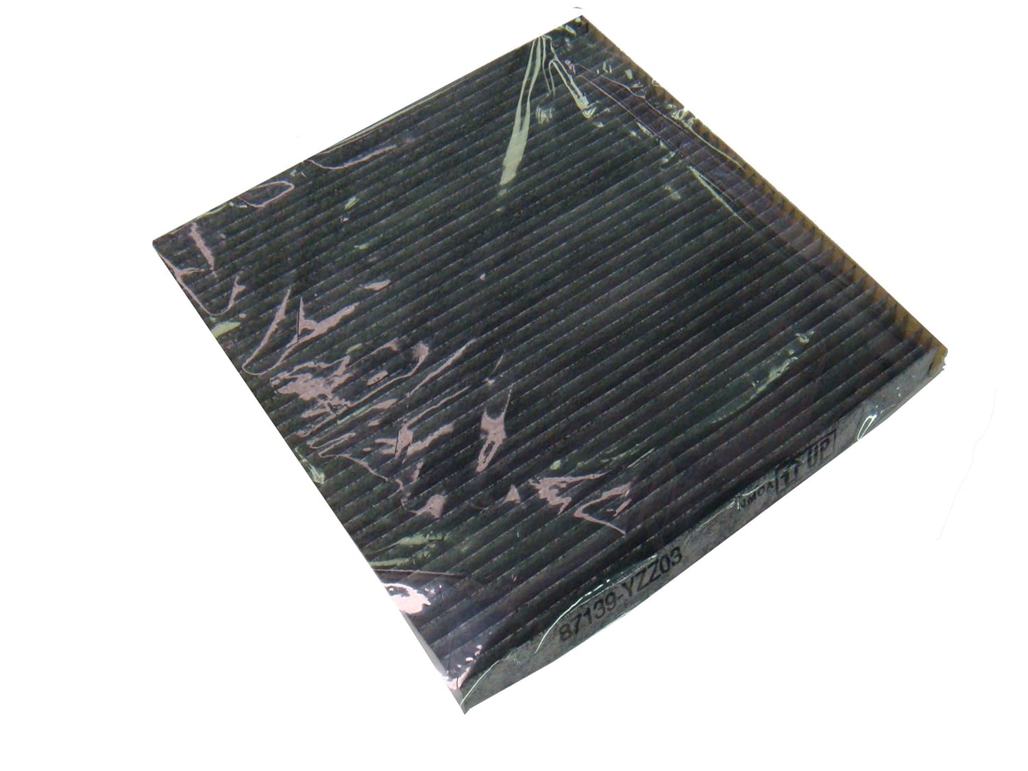

    Not a bad idea, but either Toyota's carbon filters have carbon on both sides or they also can't decide if they want charcoal up:
    Or charcoal down:
    #9 Josh Lyman, Jul 29, 2017

    hmm, maybe they impregnate the whole thing.

    I'm concerned with carbon flowing into the air tunnels...
    But, OEM UP means UP, and I think Fram followed that, opposite to flow, which are the way most arrows are pointed. (It took me a few months at least to think to try and compare with the others I had). One surface of the Fram is white. One on the Frecious Plus is yellow.

    Pictures sometimes aren't clear. I usually switch the OEM one for the Fresh Breeze or (now that I know about it) Frecious Plus. But some mention is made that they are not really effective and do seem to decrease flow. At least with the Fresh Breeze, I can somewhat notice it. Not using the car with the Frecious Plus much, but didn't notice decrease of flow the little I did.
    Even with the OEM Toyota filter, one side seems lighter than the other, no?
