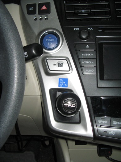

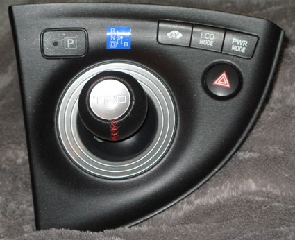

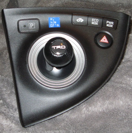

    Some of the best looking Toyota TRD shift knobs are NOT available for automatics or Prius models, because they have M12x1.25 internal threads.
    Today, I received two of the nicest genuine Prius TRD leather covered shift knobs that I ordered from Amazon.
    For nearly two months, I have experimented in making adapters for Prius models from hardened ISO 8.8 hardened steel bolts. These require aerospace grade hardened cobalt and carbide drills and taps to successfully machine. And, the tools are quickly worn out and expended in the process.
    Unlike plastic and aluminum adapters, these are the same quality as the original shifter shafts.
    The smaller TRD shift knob is the same size as the TOM's, but much nicer to grip than the plastic Delrin or Duracon acetal plastic of the Tom's shown here in the eBay listing.
    Toyota Prius ZVW30 NHW20 Tom's Hybrid Shift Knob | eBay
    There is one adapter for the recessed thread knob and another for the smaller non-recessed thread knob.
    Also, I made several for the Prius"c" and other Toyota automatics with M8x1.25 threads.

    Looks great! Especially the TRD 008 picture.

    I don't understand the need for that grade material.
    Are you saying that the Prius shift selector is that strong?
    The gear selection loads have to be tiny.

    In these days of below quality disposable parts, I prefer to take extra effort to make these the best possible adapters.
    I've heard of a lot of experiences of those who have "wobbly" shift knobs using cheaply made ill fitting plastic adapters.
    A substantial adapter weighs about an ounce. To save 2/3's an ounce by making them poorly is false economy. If it was for a few hundred parts on the car, the weight savings would be significant.
    I would rather make a quality piece that outlast the car.

    I was commenting more on the hardships and tool wear dedicated to using the 8.8 material.
  8. Mike500
    Mike500 Senior Member
    Mar 1, 2012
    2,593
    767
    I'm using the durable material, because I have had a great deal of experience in machining tough high performance aerospace alloys.
    The material I equivalent to the steel used in the shaft of mechanical manual shifters.
    That means anyone using the adapter will NEVER have to worry about a failure.
