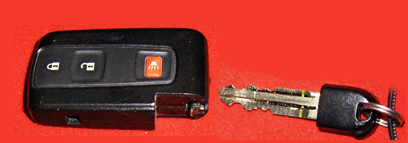

  8. mmmodem
    mmmodem Senior Taste Tester
    Nov 17, 2011
    2,732
    1,703
    Bay Area, CA

    Sometimes people think it is successful, but it is not.
    The original key is nearby and is doing the unlocking, instead of the replacement key fob.
    Once you get back into your car and have the key fobs we can help you check things out.

  10. tvpierce
    tvpierce Senior Member
    Apr 27, 2015
    951
    883
    Maine
    2013 Prius v wagon
    +1
    Unless you've removed it, you should have a key in the FOB.
