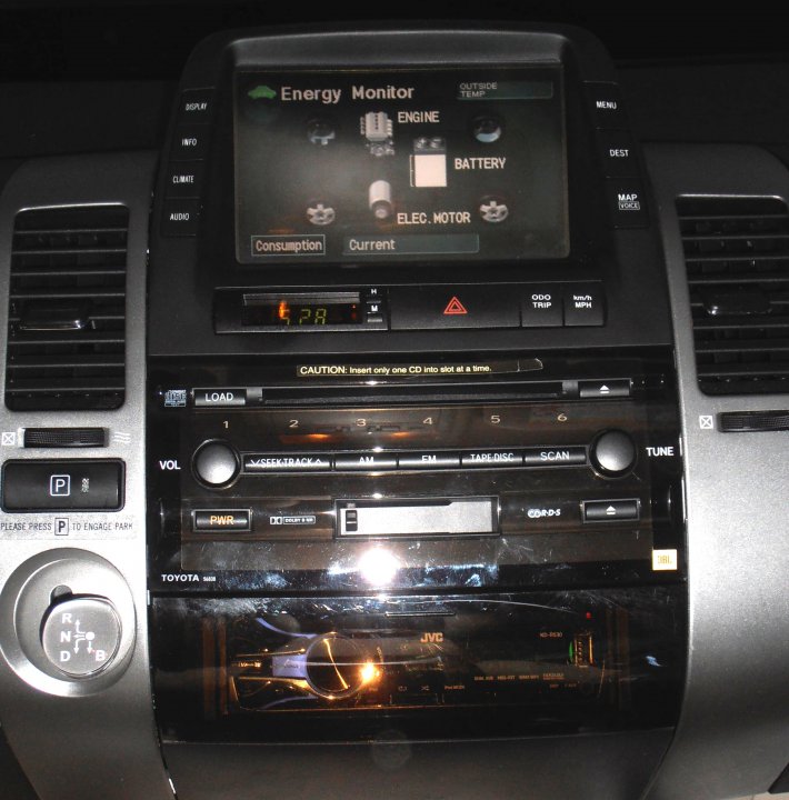

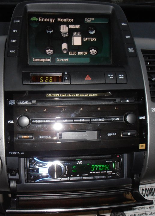

  14. Epiphany2000
    Epiphany2000 Member
    Dec 23, 2013
    126
    San Francisco Bay Area, CA
    Actually, I was talking about doing a stealth install, which does not involve removing the stock head unit. I apologize, as I should have been more clear in this regard.
    Does this refer to putting a single DIN radio in place of the stock radio, thereby only taking up 1/2 of the stock radio's space, or doing a stealth installation in the pocket underneath the stock radio? Or do you think they both look like crap?
    I did the latter, and think it looks pretty nice (see photos)

    The single din in place of the stock stereo-bad
    Double- good, but easily seen and stolen.
    Stealth- awesome! I just researched this and it looks great! Wow!
