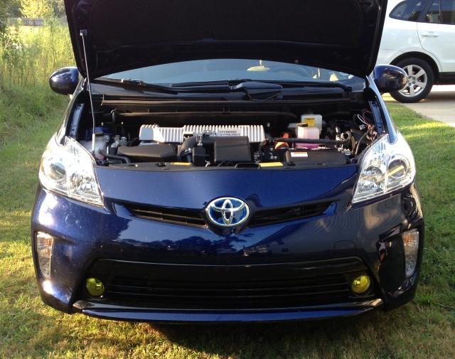

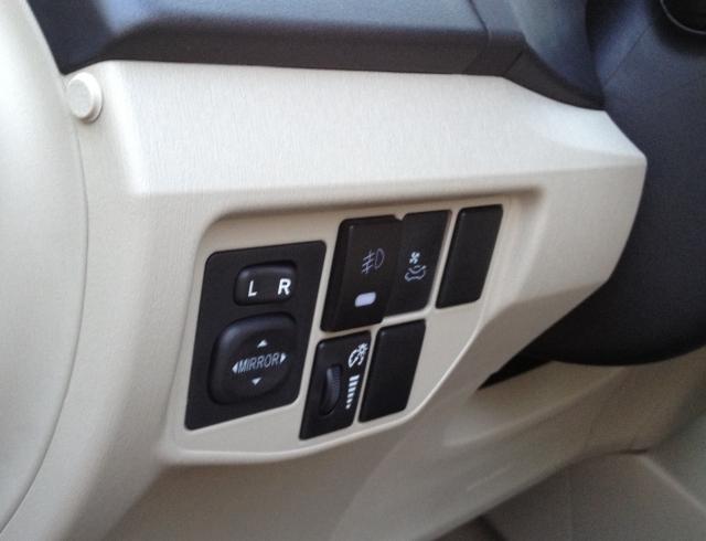

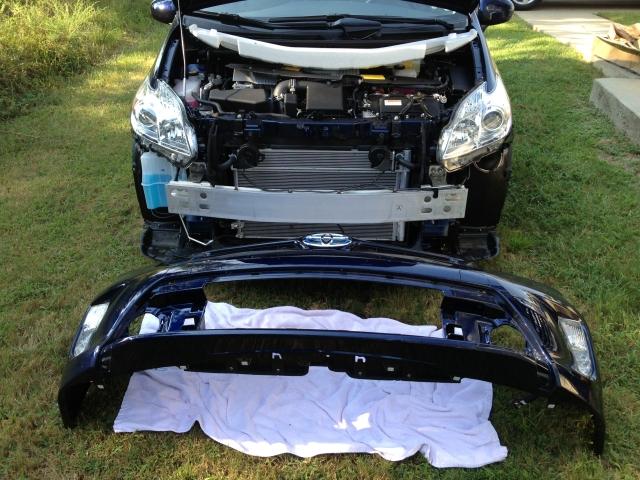

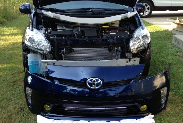

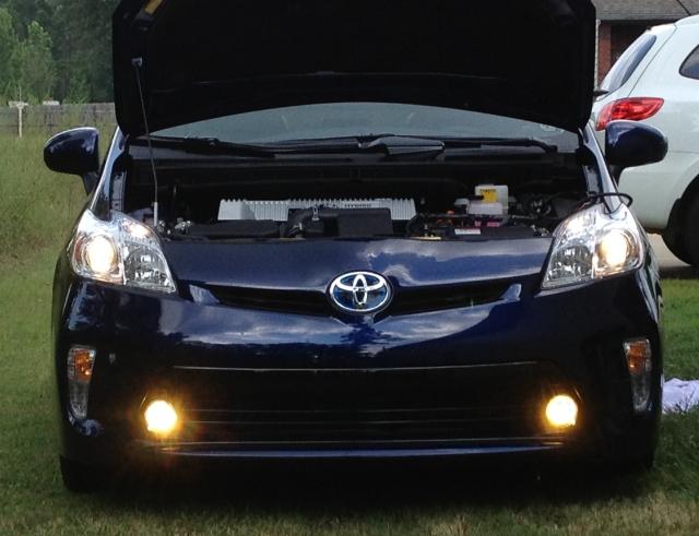

    Hi PC,
    . I also installed a fog light kit on my 2013 Prius 4 Solar. I ordered the grill from TRD Sparks, and generic Yaris Yellow Fog kit from eBay ($39.99). The fog light switch looked correct, but it actually sticks out from the other switches about 1/8" and the back lighting is yellow not green. Oh well... :confused:
    Anyway the kit came out OK. I also installed bright LED's inside (looks like a football stadium in there) and out, and installed the chrome lower rocker moldings. I had to completely remove the front end to get to the grill clips and that took a bit longer than I planned. As you look at the photos, you can see the sun rise and set on me. The mosquitoes ate well that day! ;) I chose yellow fogs just to be different. I have to adjust them down a bit. Some pix for you:
    -Zed (y)
    Update (9/6/2013): Noticed since connected relay trigger to brown wire (parking lamps) this means fogs stay on even if high beams are turned on. This may not be legal in some states...

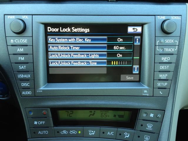

    Update: 9/28/2013
    . Even though my door lock/unlock beeps are now disabled (and the feedback lights flash stopped), I found the flash and beep volume level ARE adjustable with the radio head unit (I have the Premium NAV). I think the settings are in the same location in the other NAV unit as well:
    Press NAV unit 'Setup' button
    Select: Vehicle 'Icon'
    Select: Vehicle Customization
    Select: Door Lock Settings
    Scroll to bottom...
    Select: Lock/Unlock Feedback: Lights (On/Off)
    Select: Lock/Unlock Feedback: Tone (Level |||||||)
    Select: Save
    That's it!
