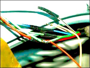

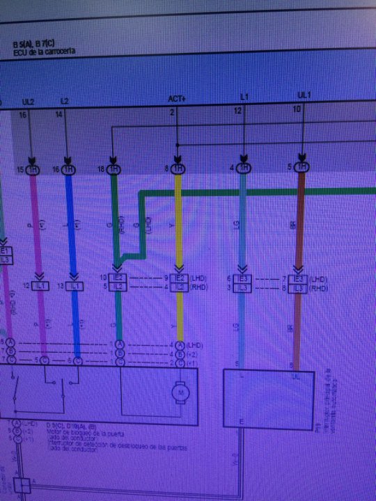

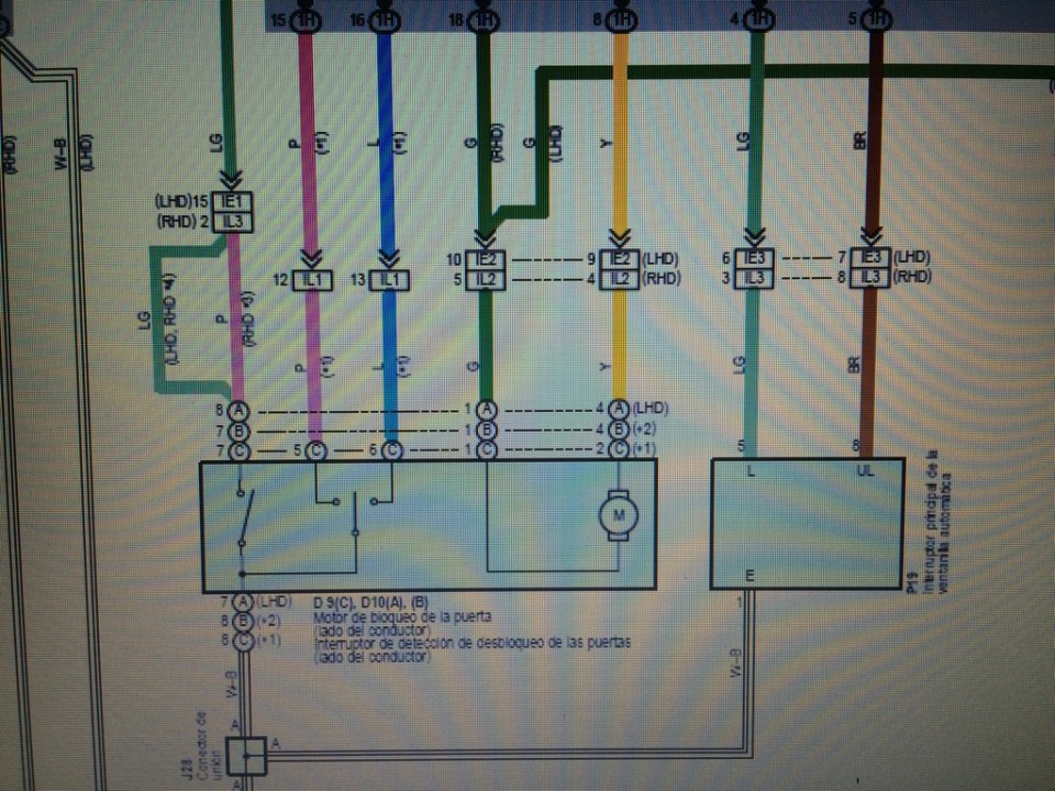

    Hi! my prius 08 (European) does not have that factory installed with call option beep sounds, I'm opting for the scheme to connect the electric motor shutdown. Greetings! ImageUploadedByTapatalk1416129879.252955.jpg ImageUploadedByTapatalk1416129886.953155.jpg
    ImageUploadedByTapatalk1416133012.255786.jpg ImageUploadedByTapatalk1416133192.220338.jpg ImageUploadedByTapatalk1416133203.652996.jpg

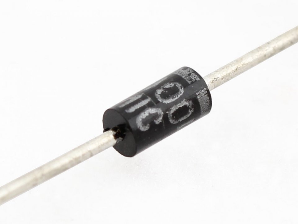

    ,your solution seems exactly what i need, i have prepared the diodes , the only problem is i can barely understand the wiring can you please send the colors ?
    on your diagram,
    is this positive trigger or negative?

    in addition have found the motor wiring green and yellow, however it is needed to disable the alarm when the switch is open ,can be done with relay , and the main issue is that the signal for open or close will be identical...

    the function of locking and unlocking doors will be affected without diode corresponding colors are identical to photos and diagrams ImageUploadedByTapatalk1416662452.888436.jpg
