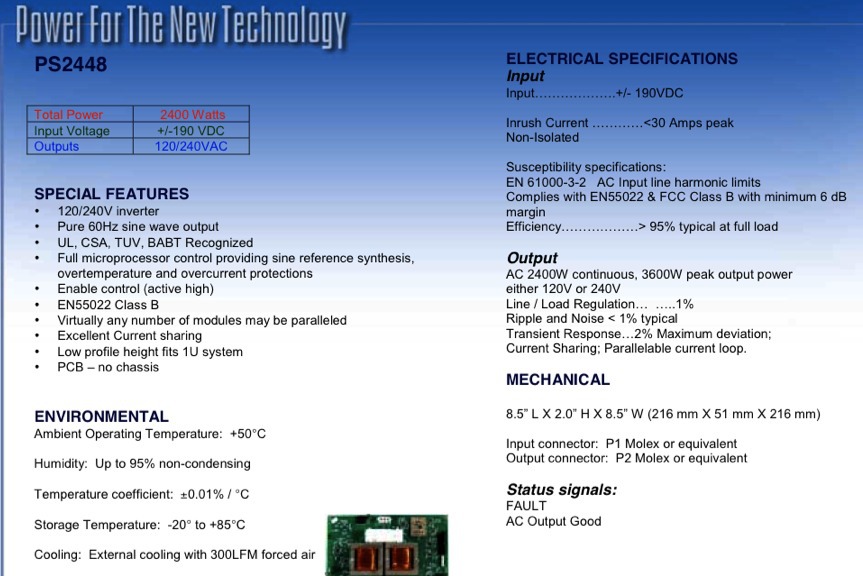

    Good point. I had no way of knowing that lol. Slightly off topic but not much: I found an awesome board that skips the 12v system and concerts 190v DC to 240v ac. Problem is I have no info on parts or availability. It's by Martek Power[​IMG]

    Call your local dealer:
    Martek
    Nexus 4 ?

    Local being 4+ hours away lol. Hey it would still be quick shipping :p

    If you call let us know how $$

    Called and left a message. Now the fun part...waiting lol
