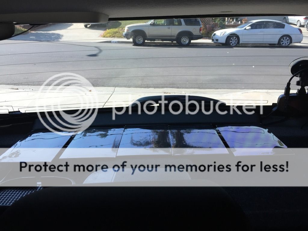

    Very true, it's excessively slow, but in my eyes it's capturing energy over a long period of time, that would have been wasted anyway. Luckily I wired it so that the panels cannot exceed 5V, but at excessive high produces 2.8A outside of the car in direct sunlight. Considering the panels are behind glass/tinting and inside the car, it's a realistic 400mA. In this case there's no voltage regulator (insert EE whining sound), and it's attached to a lamo 5V usb battery. The entire setup weighs under 1 pound and the waste energy gathered into the battery feeds my wife's phone and tablet. If I have passengers it feeds them in the back as well.

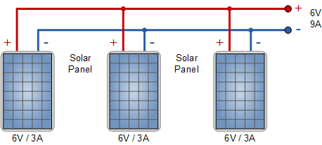

    Assuming you bought 5, wired in parallel, following this pic:
    It would produce 5V with 2500mA at excessive ideal peak. Considering the panels will be behind glass, they'll be about ~20% as effective. I wired a female usb socket to one end of it and used the power coming in to charge a usb battery. Not all usb batteries will charge with the massively small and varying amperage, but through trial and error I found a 16000mAh external battery that would charge with as little as 100mA. Frys has one with the flag on them periodically on sale for $20. Link of that model below:
    MEGA 16800 mAh LCD Powerbank
    I'd like to point out that since upgrading my tinting from weird purple to metallic tinting, the rear solars produced ~10mA, essentially nothing. I've eventually moved them to the house and they, combined with other solars, were immensely move productive there.
