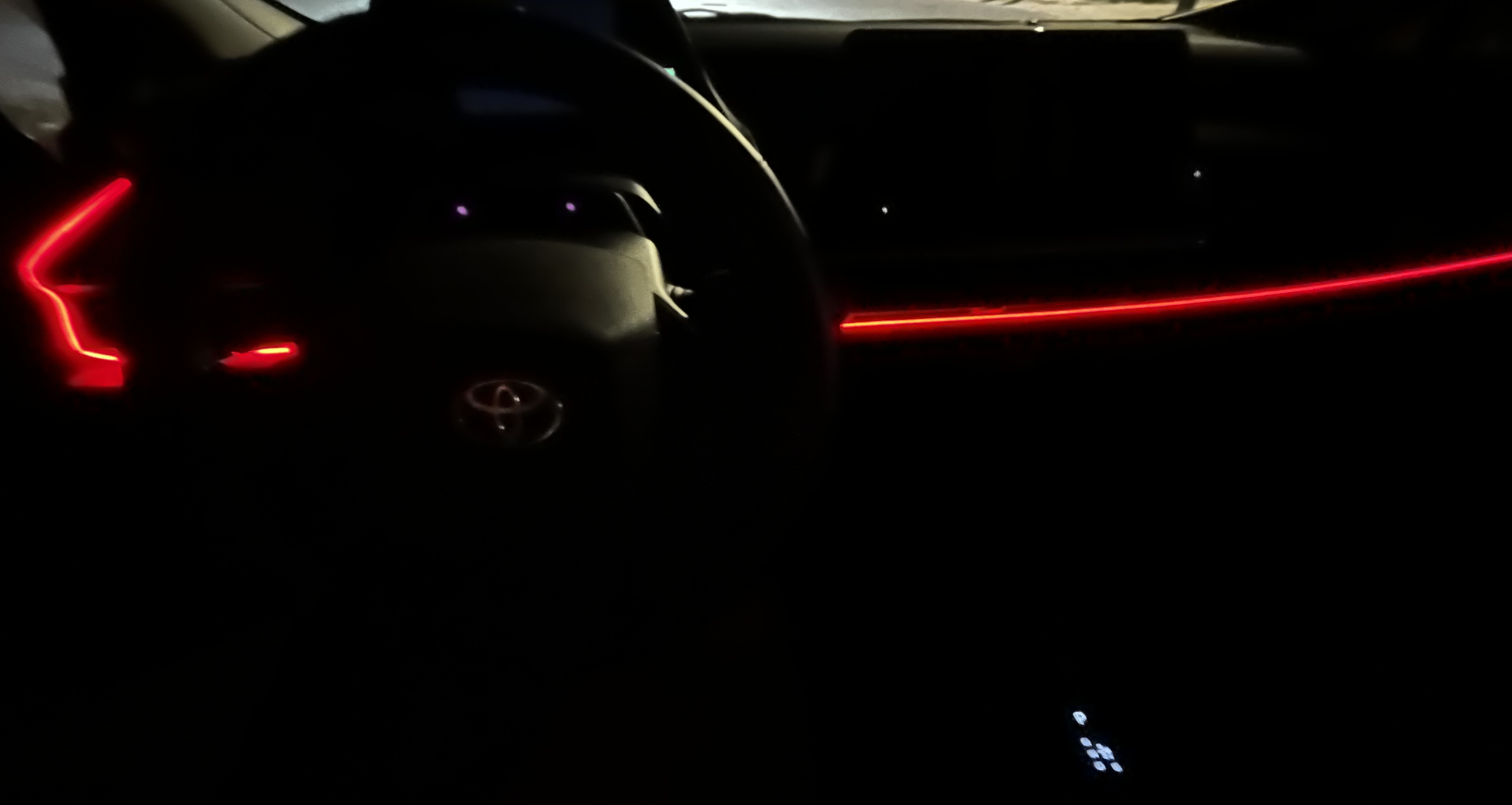

    I installed my lights slightly different than Deathcommand by running it high on both sides. I slid the wires through the trim so no wires are sticking by the door.
    Final in daytime looks like this:
    Daytime on:
    The left corner by the start button is white because I cut it poorly (don't use a pocket knife)
    Night time shot:
    Total cost me about $20.
    Considering the originals cost about $1000 in parts and need to dismantle the dash, I think these are worth it.
    Drawbacks:
    - The LED strips don't usually come in long enough lengths for the right side so there's a small link in the strip. I can see it but it doesn't bug me too much.
    - For some reason, the ambient light "alerts" only work for the left side. From what I managed to check with other owners, on the OEM version, when you're stopped at a red light and the car in front of you started moving, the whole ambient light would start flashing to "warn" you. In this version, only the left side does it. Since I extended mine to the top of the trim, I actually prefer it this way.
    This was also before I added the footwell lights.
    All in all, I'm pretty happy for the price. Both the ambient light and footwell lights dim at night and stay on all the time. The ambient light isn't distracting neither day nor night.
