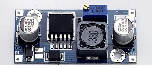

    I recently used a couple of these to step 12-13vdc down to 4.5vdc...
    It can easily drop 6.5vdc/12vdc to 3.3vdc- and it handles up to 3 amps.
    "LM2596 Buck DC-DC Adjustable Step Down Power Supply Module Converter"
    $7.29 (for two) on Amazon.

    ny_rob,
    I see it can do 3 amps. I wonder if that is too much current for the "orange wire" can carry.

    The 3 amp is the maximum capacity. It does not mean that 3 amps will flow through the orange wire so you will be fine.

    It will only draw as much as the cam requires- plus a few milli-amps for overhead.
    If the cam pulls 1000 mA (1 amp) the converter will draw maybe 1050 mA total... it's a very efficient unit.
