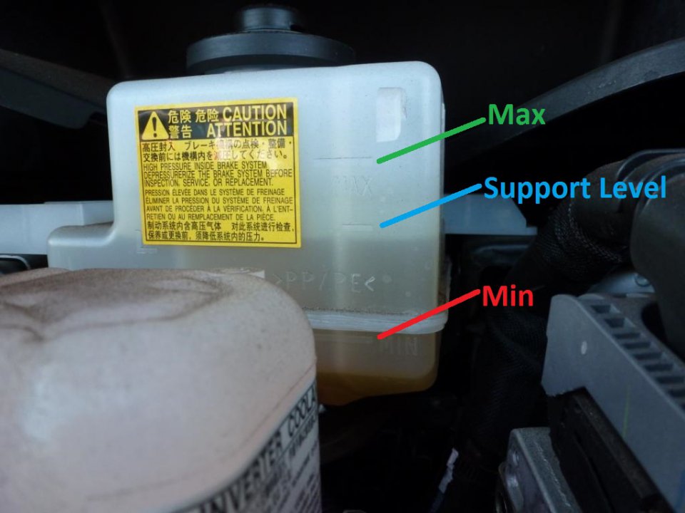

    Just to make sure everyone is on the same page...
    The brake fluid level in the reservoir will vary with the amount of fluid in the brake accumulator.
    The Max level is the brake fluid level in the reservoir when the accumulator is completely discharged.
    You would almost never see this in normal use. If you wanted to discharge the accumulator, an easy way is to disconnect the 12v battery, and then pump the brake pedal up to 40 times. Somewhere between the 20th and 40th pump, the brake pedal will become very firm. This is when the accumulator is discharged.
    The Support Level is the max fluid level with the accumulator fully charged.
    When you first open the driver's door, the brake hydraulic pump runs, drawing fluid from the reservoir and pressurizing the accumulator, preparing the brake system for driving.
    Pump the brake pedal a few times, the pump will run and then stop. Check the brake fluid level. It should be near the Support Level.
    The Min level is below the seam of the reservoir. If your brake fluid is near the Min level, the Red Brake Warning Light would remain ON anytime the vehicle is in Ignition ON or Ready mode.
    If your brake fluid is near the Min level, the brake system will require inspection.

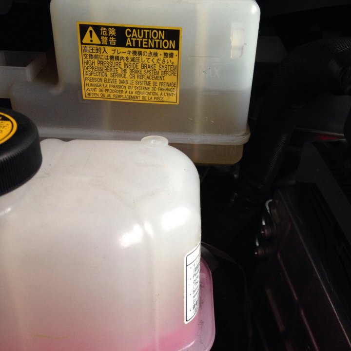

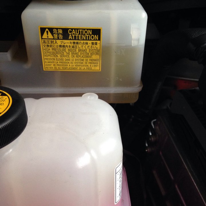

  13. Mendel Leisk
    61,529
    42,343
    Interesting. I opened passenger door, reached across to release hood latch, then took this pic:
    Then opened driver's door, let the sounds subside, and took a second pic:
