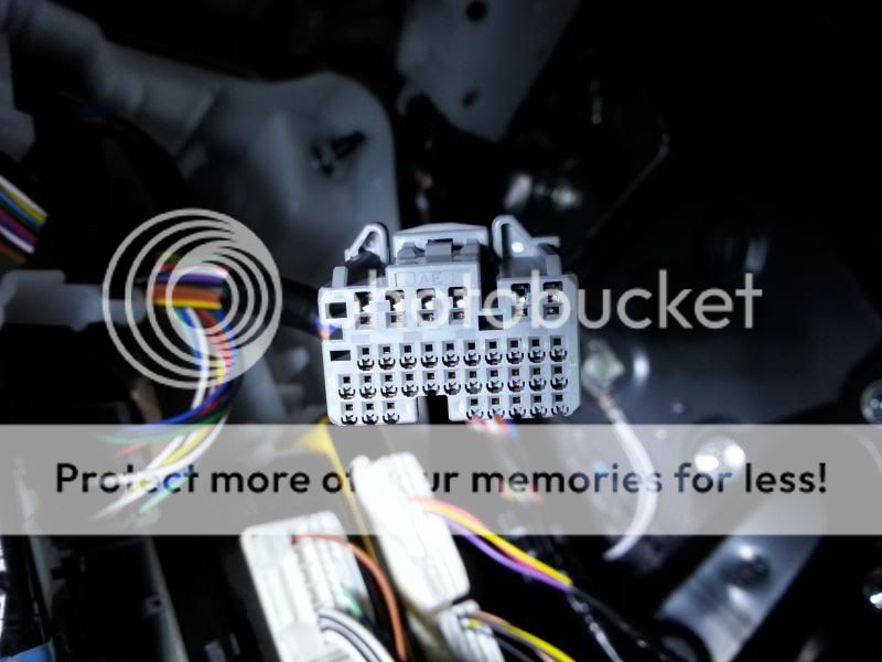

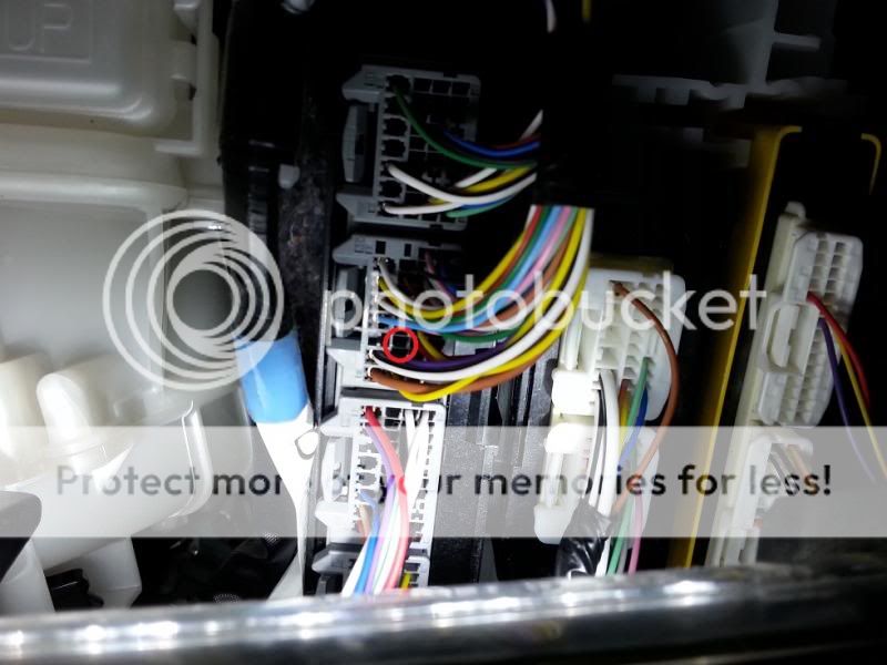

    Thanks for the info, Priusinparadise. Looking behind the glovebox, pin L5-13 on the ecu connector is missing the wire for EV mode. I think just adding this wire and connecting it to the EV mode switch should work - only problem is I have no idea what kind of pin I need or where to get it. Here's a pic of the L5 connector with the missing wire in the #13 place for EV mode:
    Here's a picture of the other side of the connector after removing it from the power management ecu. I searched for "JAE F" connector and couldn't find specifics or pins for it. Does anybody know where to get pins for the L5 and L78 connectors?

    A good idea, but I don't believe the wiring harness for the head unit uses the same type of connectors/pins that the power management ecu does.

    Bump for connector/pin info on the pwr mgmt. ecu L5 connector and the EV switch L78 connector. I think I'm just a couple pins away from getting this to work.

    I've still been unable to source the pins for these two types of connectors. Please chime in if you have info on them, thanks!
