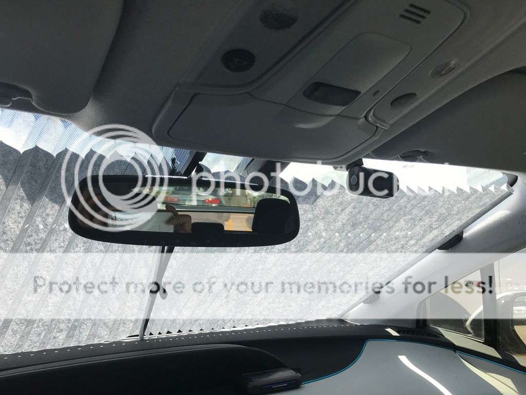

    texas
    so out of boredom, I bought a HomeLink/Auto dimming mirror off eBay for $30 and installed it yesterday. Takes about 15 minutes. Works great. There isn't any plug available as mentioned before but there is only 3 wires. Pin #6 is ignition, #8 is ground and #10 is constant +12v. The constant 12v is red wire in the overhead console. Ignition wire I ran from the fuse box up (for my hardwired dash cam which is already there) so I just tapped into that. Ground, I just drilled a hole and bolt into the metal support tab.
  18. randomwalk101
    randomwalk101 DYI'er
    Feb 4, 2012
    532
    271
    texas
    Adding a pics of the mirror
