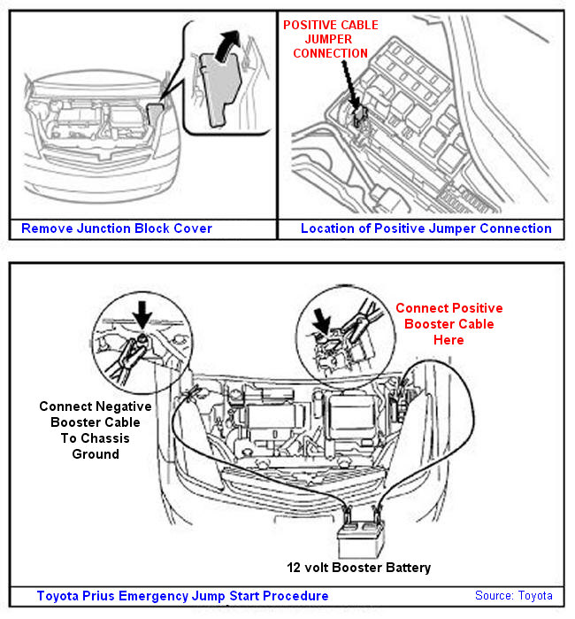

    I had an old 2012 C; I thought there was a clip point after removing the fuse-box cover on the drivers side. I think is was a skinny silver tab, not wide enough for a standard battery jumper cable clamp - but I do remember it being there.
    https://www.aa1car.com/library/prius_jump_start.jpg upload_2025-11-2_11-32-21.jpeg

  5. BiomedO1
    BiomedO1 Senior Member
    Mar 27, 2021
    4,641
    2,435
    Left Coast
    As I recall; pulling that access panel and putting it back on without breaking something was a PITA. That was doing it in my driveway, before finding out about the jump point under the hood. I'm talking about new plastic, only a couple of years old - not decade old stuff that's likely much more brittle.:(:rolleyes:o_O
