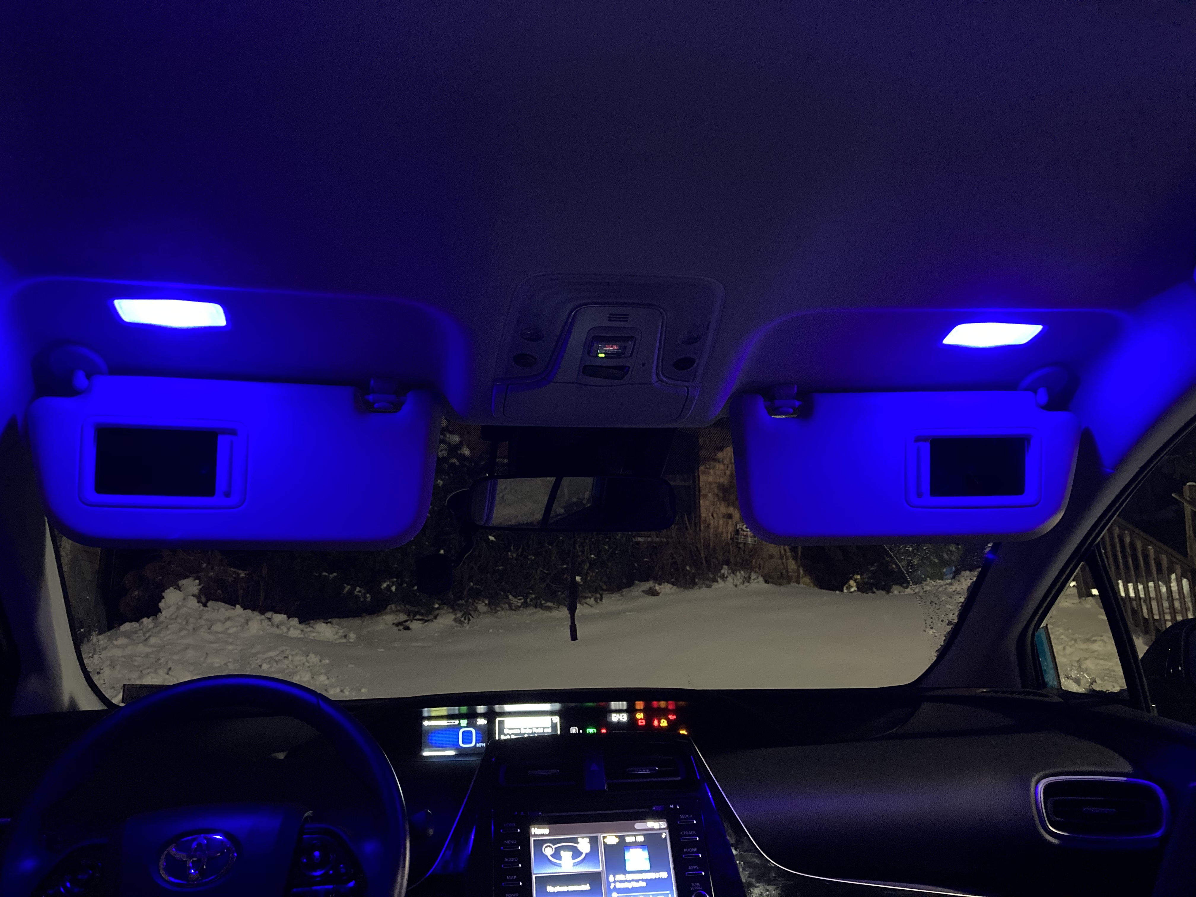

  10. Storm88000
    Storm88000 Junior Member
    Jul 4, 2020
    69
    32
    Allentown, PA
    2020 Prius Prime
    So because my Prime is blue, I swapped in 5 blue interior LEDs:
    1) Both vanity mirrors
    2) Both front door safety lights
    3) Rear trunk
    I know it may not make the *most* sense not make these bright white, but I’m a male & rarely have to check on my makeup. Lol. The GF was like “what the heck?” when she inevitably pulled down the sun visor and slid the mirror open and saw the blue light. But she said it’s bright enough.
    I just think it adds a nice yet more subtle touch than white, and you can sort of drive with them on, I guess. I mean for a bit. They don’t mess with your outside vision:
    I swapped in super bright white LEDs in the both map lights & center dome light so I wanted a little variety.

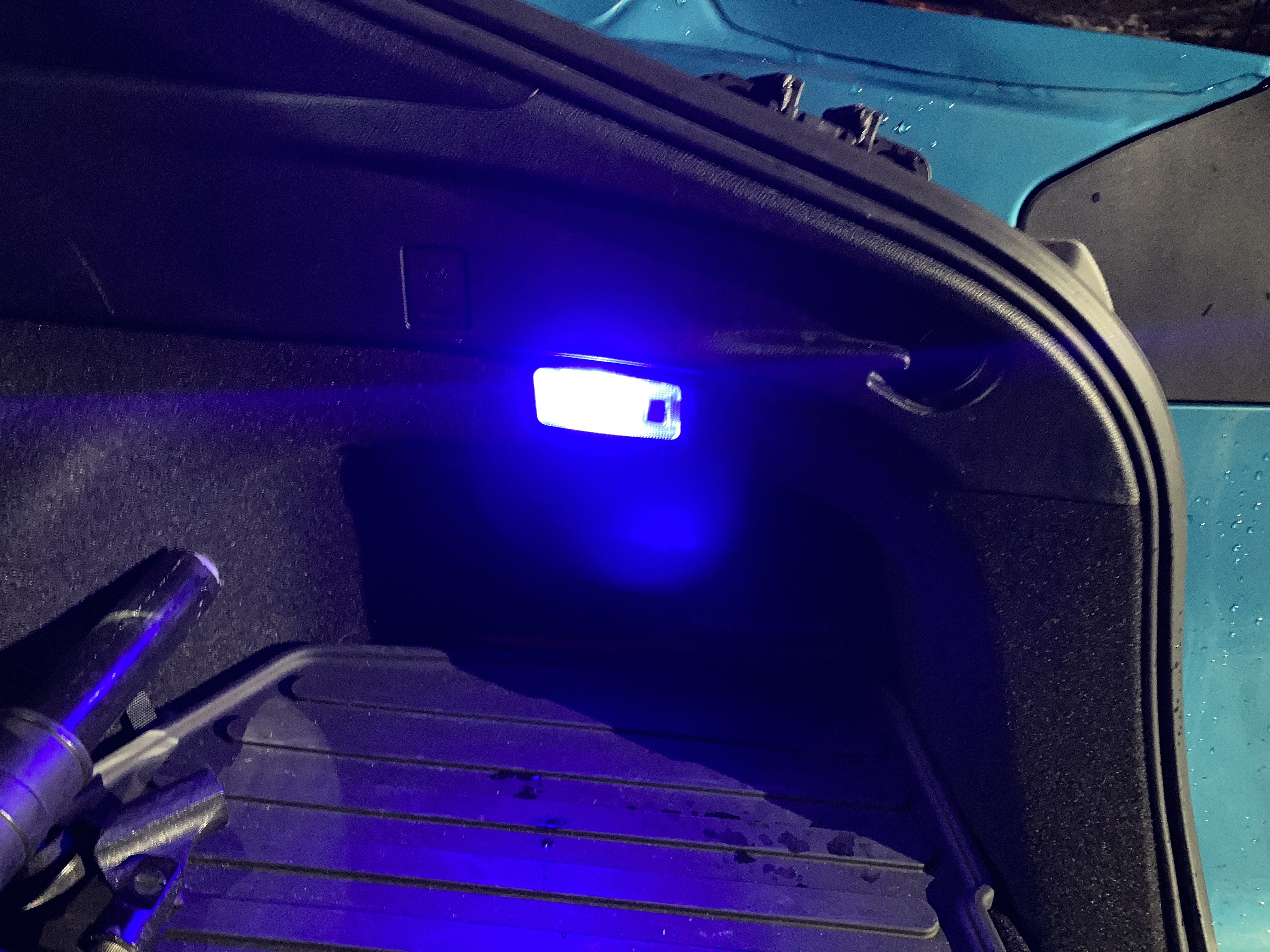

    ^^ Ok so this blue one for the trunk *probably* would have made more sense being a super bright white like the rest of the interior lights being it’s a large trunk and the white would allow me to see better, butttttt it’s okay for now.
