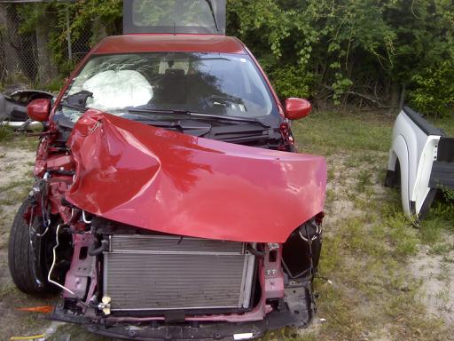

    I'd like to snag a top undamaged radiator out of a 'donor' car

    I have used aux fans alot in other high performance cars and they are very hungry.You must use a switching relay from battery B+. G2 already has very efficient fan set up not sure if aux push fan would help. I think you would achieve superior results using standalone G3 Inverter tank instead. Like the doner car idea.Fan not needed in stock G3 set up. In G3 not having the Inverter rad coupled with ICE coolant rad solves the heat soak issue.
