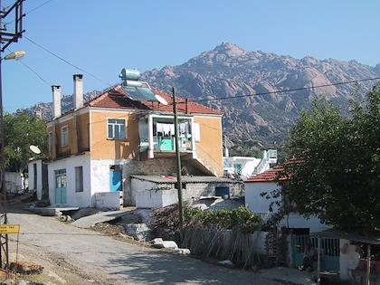

    Most houses in large areas of Turkey have a solar water heater on their roof. Apartment buildings, hotels and businesses often have many solar water heaters.
    In any given village or town they tend to look alike, probably made in some small facility not far away. In the cities there is more variety. The most common variety has one collector and a single horizontal tank at the top of the collector. Our guide, who was big into the environment, said basic units run around $400 to $500 and automatically drain to avoid freezing.

    Nice picture. If freeze protection is built-into the ICS system shown, I think it is dependent on a valve.
