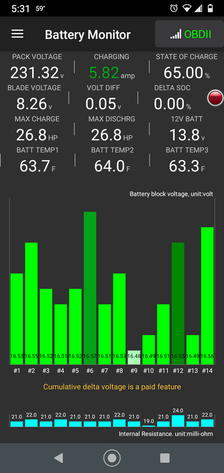

    I'm having issues with a Greentec replacement battery, and was looking for advice, and what others' experiences with this company have been like.
    Greentec replacement battery for my 2005 Prius installed October 2021. October 2024 the battery began having problems. Car would go from full charge (all green bars) to empty (one or two red bars). Informed Greentec of this problem December 16, 2024. I had 10 months of warranty left at that time. Told to monitor the behavior and they would honor the warranty. Battery continued to demonstrate this behavior.
    Battery is acting much worse now--the full to empty happens at least once a week. Reached out to Greentec last week, with battery diagnostic screenshots showing inconsistent voltages across the battery blocks: one at 19v, and one at 24v, with the remainder at an expected 21 or 22 volts (if I'm reading the Dr. Prius output correctly). Taylor Barthel at Greentec blows me off with a boilerplate response.
    I had a bad feeling about the battery when I bought it, as the open part of the case (not the sealed part, the small hatch to connect the wiring) was littered with extra washers and snipped-off connectors, but the battery had excellent performance up until last year, when it began displaying the full-to-empty problem described above.
    What should I do? The battery is technically out of warranty, but I told them of the problem in December 2024. Is there a better way to figure out what's going on in the battery without opening it? I'm guessing either a bad cell/cells or some loose connections.

  9. Hayslayer
    Hayslayer Active Member
    Nov 6, 2024
    540
    331

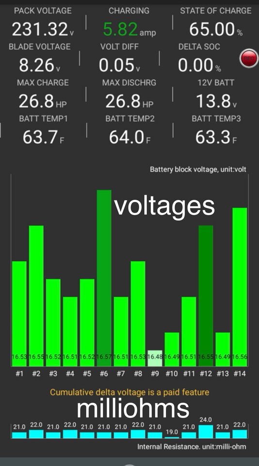

    This is not correct. You are looking at the internal resistance readings of the battery modules not the voltages. Your actual module block voltages range from 16.48 to 16.57 volts, which at first glance the bars look all over the place and makes you think there's a problem, but that's only because of the way they are scaled. They are actually pretty tight, with only a 0.09 difference top to bottom. What you have to understand about your screen capture is that the battery is being charged at 5+ amps and that can hide voltage variation. It would be easier to see deficiencies if the battery were under a discharge condition.
    As for the green bars to red bars, that can also happen depending on your driving habits. Under what conditions does this happen? How is the car being driven and under what road conditions? Do you see it after the car has sat unused for a few days or is it while actually driving? while sitting in a parking lot with the AC on? Happening once a week is a bit unusual if the pack were actually bad.
    When you say the pack was made from 'new' modules, were they new prismatic modules from Toyota, new prismatics from aftermarket (ie not Toyota) or new 'D cell' style modules from an aftermarket supplier? This makes a huge difference in expected trouble free lifespan.

    Based on their wording (avoiding saying new OEM modules), and the blurb about precision matching, I'm going to guess they are third party modules. It would be interesting to see a photo of the internals on this battery.

    Because you're the super expert that couldn't even recognize that 20+ volts is pretty much impossible, right?

    As stated above, you need to define the timing and conditions to see this behavior. Sitting at a stoplight for 3 minutes with the ac on? Or shutdown overnight? Or...
    As stated above you need to communicate to Greentec with accuracy. They are very likely to brush you off with clearly inaccurate descriptions.
    The milliohms could be better but not a change out indication yet
    Dr Prius is not an acknowledged testing standard, it's simply a tool the Lithium/sodium guys put out to display data.
    The real question is have you gotten any battery codes? Toyota's original ten year warranty for carb states would have required those, much less Greentec.
    Finally, as stated above, if they sold you the aftermarket cylindrical nimh new cells, we know 2 years is typical and 3 is pretty good. If they are real Toyota oem you are unlikely to have any concerns for another 5-8 years.
