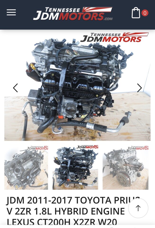

    I would get a JDM engine from Tennessee JDM Motors in Memphis.

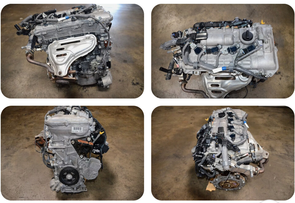

    $1000 as is depending on the rest of the car. If you want to truly part it out and sell pieces on ebay you might do a little better but you may get a 1099 from them.
    A $1200 JDM is much better than that north american used engine you were trying to find. The smart move is to pick it up so you can inspect it.

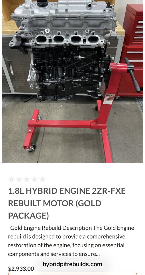

    A "Hybridpit Rebuilds" Gold rebuilt shipped to you or a shop might be $5k installed depending on your shop's install pricing. There is more install work here as the intake, exhaust, etc etc have to be moved from your engine
    The JDM comes factory assembled with everything that is on your engine when removed.
