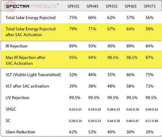

    be prepared to join my 3 brain cell lowbrow Club of disagreement.
    And now that I've turned up the squelch as Bob Wilson calls it, here's a heat rejection chart that photosync publishes;
    Their SPH75 is so virtually & very close to clear, you'd swear it is. It's just the arm and a leg that it costs we found as a downside.

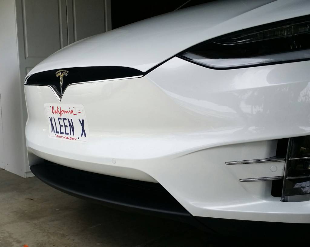

    Here's another favorite illegal activity i did a few months back, because, who wants to drill holes and lose that perfect low drag coefficiency;
    Laser printer certified, non photo chemically reactive, vinyl label license plate;
    BuaaaHahaha . . .
    Everyone that sees it, scratches their head, and then Smiles. But someday, some crime Buster will likely pull me over and make me peel it off. But i got more ...

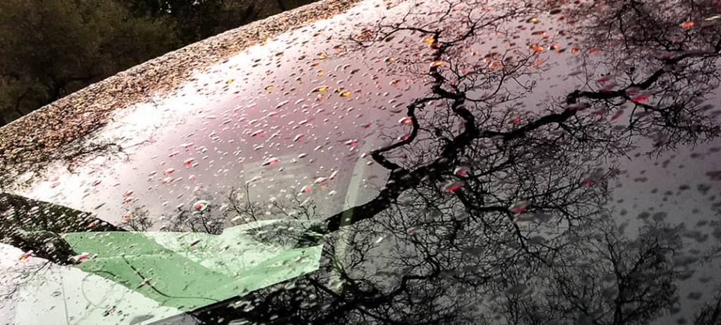

    here's our metalic coated, OEM - factory tinted windshield;
    take legality up w/ their 3-brain cell manufacturers. Explain to them they don't know what they're talking about.

    I'm sorry for the wording of my post.
    I mis-read your sentence.....and by the time I realized it the edit time had expired.
    A "coated" windshield is quite different from a "tinted" one......or can be.
    This discussion is/was about after-market tinting.
    Pretty sure that the OEM equipment has different rules.
